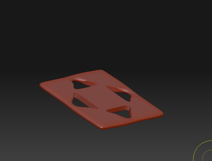

Hi, following the Tutorial on how to make a sword, i’m at the part of the guard. When it says click [Shift] to smooth down the edges, I try that and the whole thing turns very round, here it is.
Any help?
I’m using a tablet, Zbrush 3.12B
Any help?
Switch to the Smooth brush. With it selected (as opposed to holding Shift) you can adjust the Z Intensity slider. Each brush remembers its own settings. So when you hold Shift to activate Smooth, that brush’s settings override the current brush’s settings, even though you don’t see any changes in the sliders on the interface.
