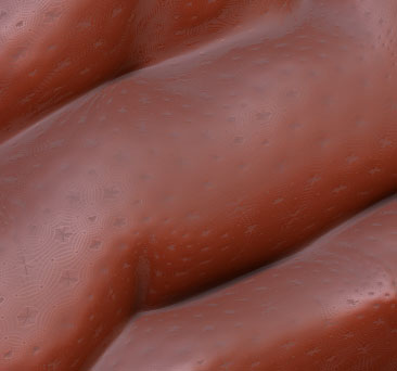

When I bring in a model I build in Lightwave and subdivide the mesh, I often get what looks like pock marks formed by the polygons.
I’ve tried using the smoothing brush but that changes the model and actually seems to accentuate the divitssmoothing.jpg . I just want to smooth it out and get rid of these “pock marks”. Is there a way to brush over a surface and just gradually smooth out textures vs adding/subtracting clay to the model?

those pot marks are 5 edged points. every sculpting program hates them…there is no easy fix for those, you have to go in and pull up every little dimple.
