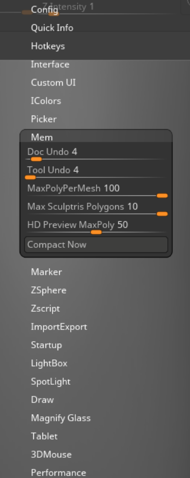

Ok, so I checked the amount of segments which is quite high. I also played with the strength multiplier but it seems to have no effect.

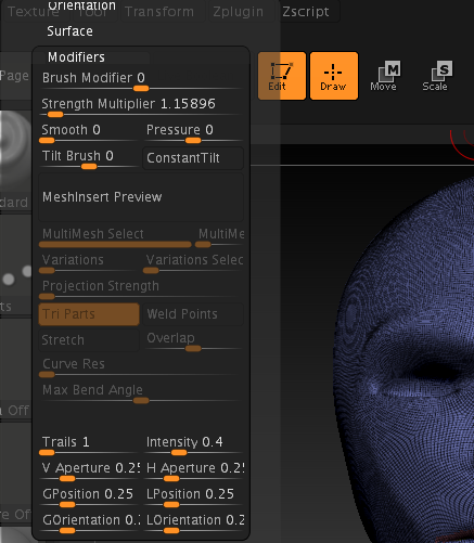

I am not quite sure how to check the density. Do you mean the mesh density. This should be ok according to the screenshot I would say. Is there another lever for the brush strength? I could not find any. Only the z intensity I set to a high value.

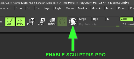

Ah and sculptris pro was already enabled according to the screenshot

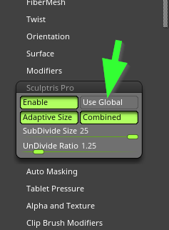

I am just wondering if there is another Sculptris Pro menu. Because I saw in the Sculptris Pro video from zclassroom that there is an adaptive size slider.
In the “Brush > Sculptris Pro” subpalette, if you turn off “Use Global” button, then the “SubDivide Size” and “UnDivide Ratio” sliders will become available to you. Raise the “SubDivide Size” slider to reduce mesh density. Make sure to enable Sculptris Pro.
Thanks @zber2. that helps. Sculptris Pro mode is amazing in case of sculpting parts with more details whereas other parts can be left without detail.
