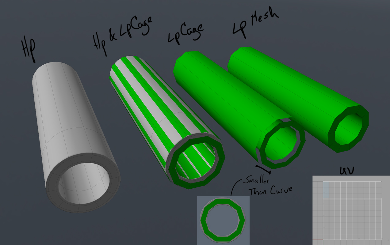

The problem comes from the curve of the object and how normal maps are a raycast from a normal vector.
The proper type of cage is displayed in this image. In order to avoid the artifacts you need to ensure your mesh is going to cast and hit a surface.
I don’t understand why you’re trying to push a normal map on a cylinder anyway…but hmm, maybe I don’t see something you don’t.
Anyway…if you have any questions about the image just ask.
Nice picture, is there a way to increase the cage size in Zbrush anymore? (Zmapper got the boot, and the settings seemed to too.)
