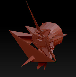

My most recent problem that I felt needed this ability was a messed up project.
You know… Some portion of your model ends up looking like a mutated seq urchin :cry:
(missed in my case because it was a small almost hidden portion of the model).
Sowewhere under there (possibly) is some recoverable lo-res mesh.
Attempting to fix such a mess by dropping to low-res and cleaning up there gets
negated as soon as you go back up the divs. The lo-res gets messed up again.
Iv’e even managed to tear holes in meshes (making them unusable) trying to clean
up things like this with smooth and move.
The only solution I’ve found is to stay up at hi-res and smooth the bejeesus out
the thing - and start from scratch. But even that doesn’t work too well if the
problem area is an isolated polygroup (because smooth … doesn’t on edges).
