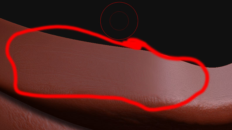

hi there, I have an urgent problem concerning the use of the smooth brush (with shift and the smooth brush itself)
My mesh has 4 mio points, i am at subDlevel 9 and the smooth brush is not smoothing, it seems like too low sample rates for the brush (like dots)
any idea what can cause, i tried incresed mouse average, lazy mouse. performance on system is quite fluid…
thanks for the help

lower level is he way I chose so far, but still it should function at highest??
the zbrush 2 brush did this, I believe
