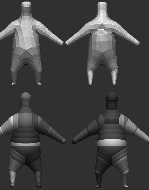

I just started using ZB and encountered this problem. I made a basic mesh and had symm on. My model appeared fine when viewed as Zspheres, but when previewing the mesh it was asymmetrical for some reason. SO, I attempted to ctrl select half of the model and smart-resymm, what resulted in the image I have attached.
Am I doing something wrong? Also, how do you deselect the mask I made?

Smart resym still needs an equivalent set of points left and right, which is not the mesh you’re starting with. It looks like you have “twist” (a sphere turned a little on its axis) in one of your body zspheres, so you should resolve that twist there before creating a skin. Use the half light/dark splits to visual inspect your zspheres.
Alternately, generate unified skin, which may turn out more symmetric.
To release mask, either select a mask out in space, off your model, -or- hit the clear button on the masking tab of the tools pallet -or- hit ctrl-shift-A.

Thank you Kerwin, unified skin works a bit better.
It really bugs me still, that I couldn’t make a symmetrical zphere, the green circle appeared, which tells me that it is centered, I tried holding shift, I tried having x symm on…
