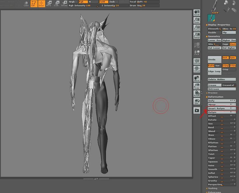

can someone advise me of my problem here?
i smart resym’d div 1 2 then on 3 this happened.
do i need a certain button pushed while i do this, or a certain axis or something?
2nd question, sorry, can i smart resym only certain areas? useing masking.

as in my previous post, my mesh shot up in the air.
the reason is the axis of the resym is being projected toward a axis direction, in that case X was upwards.

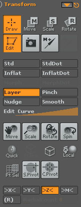

so i noticed a X Y Z toggleable buttons on the resym’s right side of the button.
I can’t remember exactly what I did but. It had something to do with clicking the local button on the right and the s.pivot. then smartresym. Let me know if this helps. I know for sure those were the buttons I pushed but I don’t know what order.
This JUST bit me too. Yep, click the button to set the center point to the center of the mesh, and then resymmetrize, it works great.
