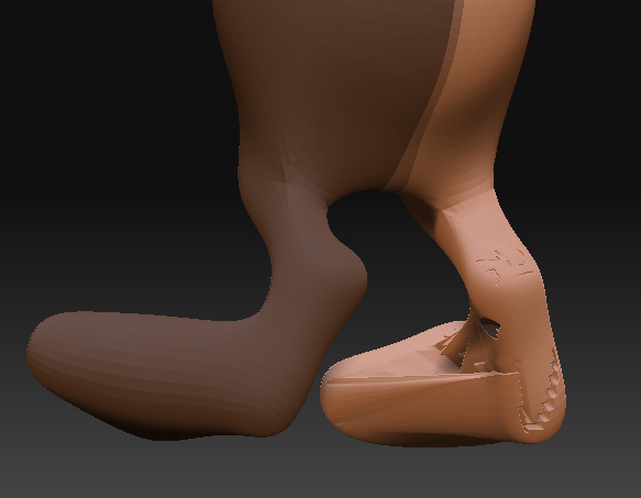

I’mhaving an odd problem with Smart ReSym -
I have a mesh which is not completely symmetrical so I decided to use Smart ReSym…
I tried doing it on every subdivision level to the highest one but I get the same problem either way. For some reason I get these distrotions:
Even tried exporting and importing the mesh as an OBJ before doing so but no luck.
Anyone knows how I can avoid this? :confused:
Thank you.

When I look in the preview menu all I see is a single square polygon… it’s filling that preview window completely, I only figured out it’s a single square polygon when I zoomed out.
I made the object out of polyspheres and trying to resym after I did adaptive skin and loaded the newly made mesh.
Yes, I tried clicking clear, also tried loading a fresh object.
Yes, I’m trying to resym the correct axis… in fact, I tried them all one time tim make sure… :confused:

I did it, it did scale down the mesh but in the preview window I still see a square polygon and the Smart ReSym still gives me that problem :frowning:
Tried it, ReSym by itself does nothing, if I click ReSym and then Smart ReSym I get even worse results than before :confused:
