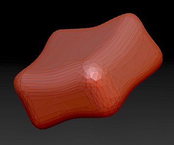

my small problem using qRemesher …

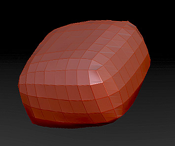

when I apply qRemesher on an object, rounded, to much, the edges ob the object… to much.
and i just need, when apply qRemesher, just SORT, reorganize, the polygons, and leave the edges like they are.
I attch 2 pictures… the original…
and the final work… but … to much rounded the edges…
can i remesh the polygons with out rounded the edges ?
What version of ZBrush are you using? qRemesher is no longer supported and you should upgrade to the latest version of ZBrush (4R6 P2). Upgrading is free to registered users.
