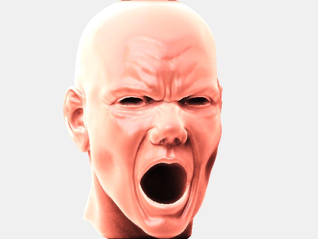

slocik: Did you apply low intensity and low saturated colors/textures to your models? The render will most definitely come out as over lighted if not. A green color, for example, with very little saturation and intensity is boosted after baking by the Render > RGB Levels curve you load. If you choose higher intensity/saturated colors/textures you will need to adjust the RGB Levels curve.
The material and the baked material are nothing special. But using this method you can concentrate on creating a low intensity/saturated render with shadows and highlights in the right places that are turned into highly saturated and intensified values after baking. getting the highlights right in the first render should help in getting the SSS effect across. It might seem a little gimmicky but the main point was to show the baking aspect. And since the shadows are baked all you have to worry about is the final look, which speeds up productivity.

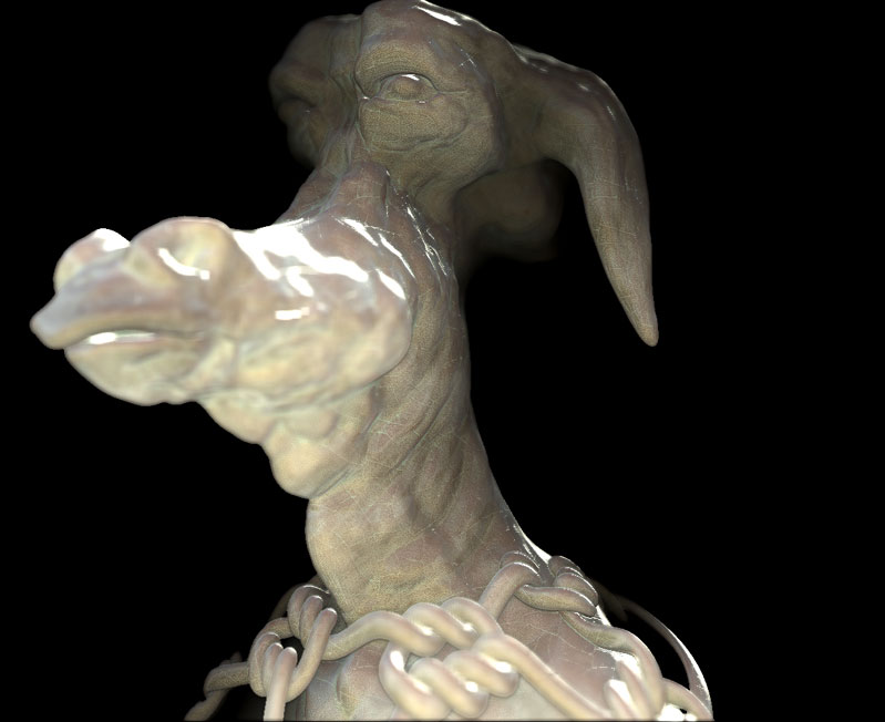

Since there are no settings for a SSS-material in Zbrush-at this moment- we have to fake the effects of SSS-render !
In my opinion we have to do it by using a material with settings for outer and inner colors in combination with ambient occlusion, and high dynamic range in order to ā€œfakeā€ the look of light penetrating the thinner parts of materials that are -to some degree- transparent and therefore translucent ! e.a. plastics,glass and skin !
Radial- and backlight can do the rest to enhance this effect !..renderengine’s like Vray have a lot of material options to do this, but it takes a long time to render !..Zbrush has to ā€œfakeā€ it but takes a fraction of the rendertime, these two renders take less then 10 minutes at a 1280-960 size -one layer no transparency-so that’s a major plus !

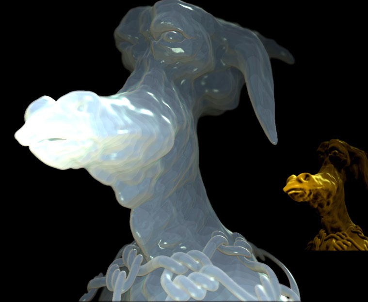

In this render i included a smaller picture showing the effects of the light and fog-settings on a simpler material

Is the SSS material dependent upon the lighting and fog settings? If so, will the lighting and fog setup work together with other materials very well? For example a creature’s skin uses your SSS material, but his clothes are a leather material. Would the leather then be effected differently than in normal lighting conditions? If it works or if there’s a way to make it work, then this would just further prove how ZBrush could be used for rendering finished art.

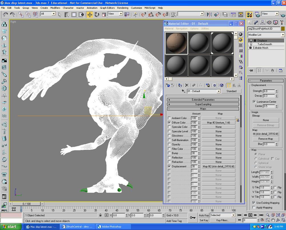

Looks like you have some excellent 3dmax skills so i thought i could ask you for some help with a problem i’m having! Here’s a screenshot of what i have in max so far. I have a displacement map and a diffuse that were both exported out from zbrush. The problem i’m having is when i put my diffuse map in the slot and try to render, max shuts down on me!! it just freezes up and when i go to task manager it says program not responding! Should the diffuse and diplacement be on separate channels, or should i be using a completely separate material for this or composite or multi sub object material for this? I dont understand. The diffuse will render fine by itself and the displacement will render fine by itself, it’s just when i put them together, it freezes on me! Please help if you can.
thanks,

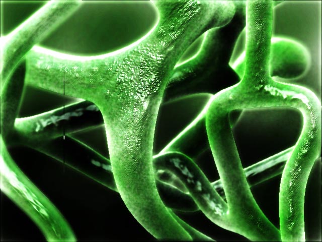

KrakenCMT : the fog, light AND material work together to create the effect…if you used more then one material in your render you would have to bake the layers…all the light needed to create the effect would "burn"all the other material setting to pure white e.a as in an over-exposed photograph !

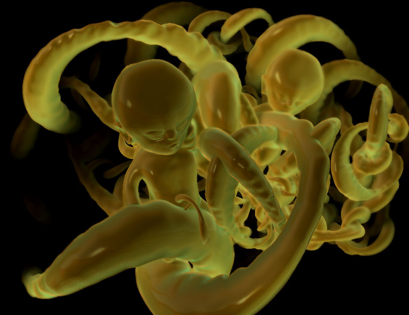

material is simple…but can be of use…i hope
jantimalienembryo02.jpggreen-glow01.zip (14.6 KB)

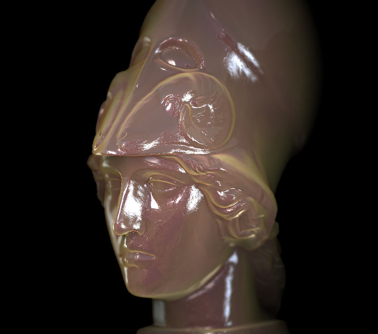

Thomaskl …i visited the Richard Rosen’s website !..interesting stuff…i thought that translucent absorbsion was almost the same as SSS !..i tried to mimic the result(s) seen on the website…i even used a deespoona-model:D

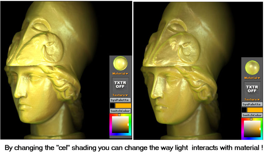

and some newbie-tips for using such a shader in ZBrush
and the material used in the first render :
the setting can be easily adjusted to create the look of the other renders
jantimmeat-glass-athena.jpgcel-settings.jpgpaint-&-material.jpgmeat-glass.zip (14.2 KB)

That`s what i wanted to see. These results are really the best of all the results here in that thread. Working very well on this model. I have to do some tests, at once !
:+1:small_orange_diamond:+1:small_orange_diamond:+1:small_orange_diamond:+1:small_orange_diamond:+1:small_orange_diamond:+1:small_orange_diamond:+1:small_orange_diamond:+1:small_orange_diamond:+1:small_orange_diamond:+1:small_orange_diamond:+1:small_orange_diamond:+1:small_orange_diamond:+1:small_orange_diamond:+1:small_orange_diamond:+1:
Congrats man - you`ve cracked up the SSS Nut in Z !

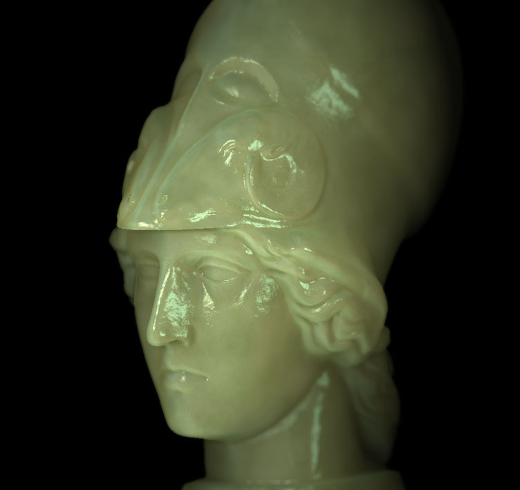

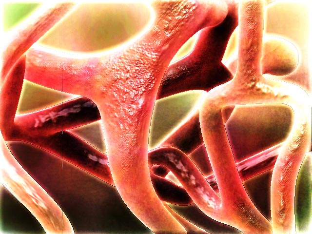

…and i hope Thomaskl, that you will not be disapointed that i not realy ā€œcrackedā€ the nut of SSS-shading !..that can’t be done in ZBrush…but you can get the ā€œlookā€ of a SSS-render !
here i tweaked the setting to get a nice jade !
