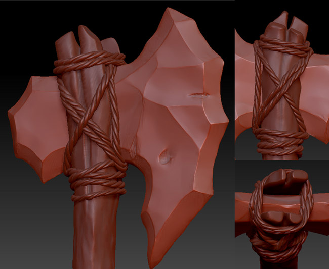

Achieving below result took me about two hours of painful attempts, undoing as soon as the curves are going crazy on the slightest pull… And the rope is not even the same curve. I had to draw it in 4 parts, hiding the tips into each other, and use move topology to replace clipped rope into right place (and slightly deforming the regular pattern in the process)… not very elegant.
The masking function doesnt even work, as it doesnt restrain any part of the curve to be moved.
InsertMultiMesh is a really really cool tool, but it definately need some refinements, like a “absolute snap” function to avoid curve being clipped into underlying structure, and the ability to be partially frozen in place with mask or parametrics (freeze X segments from start, or with a length percentage).

2 hours, ouch. What you have looks pretty good. Where did the rope brush come from?

Yep, I really struggled. I tried to repeat the process with smaller curve sections for a better precision, then upped the draw size to widen the rope afteryards, but the main problem about rope being badly clipped inside remains…
The result is acceptable, since I will slightly lower the poly count, it’s made for a 3D-printed miniature project, with a cartoon look, so The details will be lowered a bit to match the style of the drawing :wink:
The rope mesh is made from a shaped cylinder, observing the steps of the really complete BadKing tutorial. The 3 sections need to be slightly posed away from eachother, to let Zbrush weld them properly.
The cool thing is you could make different section lengths from the same base mesh with a Y scaling :wink:
