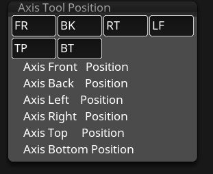

Not by rotating it, no. There is a plugin that will set it to a selected view with one click. The Axis plugin by Roland Kaiser. I use it all the time. I can’t find a download link so I zipped it below. Just extract it to your plugins folder.
Axis Tool Position 4R6 update.zip (3.4 KB)
edit: Anybody else seeing this that wants to download the plugin, it says 4R6, but it’s still working in ZBrush 2022.0.5.
