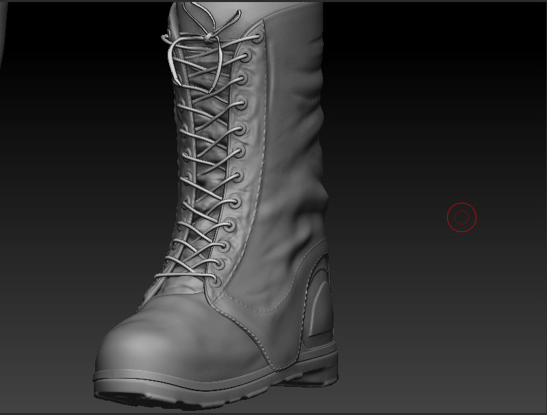

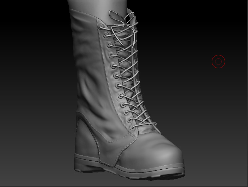

Hi guys,
Here you can see the result of the āholeā from the projection master.
Itās not really a hole, but it looks like a hole.
I donāt think it looks that bad with projection master.
Just give a try
It looks good, thanks for sharing!

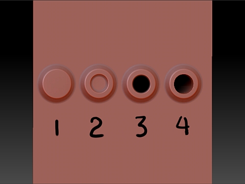

Perhaps an alternate solution not using projection master:
Mallet Brush (In your main default brush palette set) set to zadd
Add Mallet Brush sized down a bit, set to zsub and centered in the middle of the previous stroke
see above but add rgb (color black) to the inner stroke.
Same as number 3, but followed by āmask by intensityā to mask the hole. Then you reverse the mask and in the deformation palette offset the now unmasked black circle in the negative z direction a bit to create more of a āholeā
