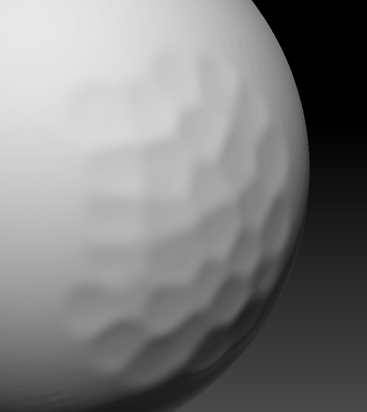

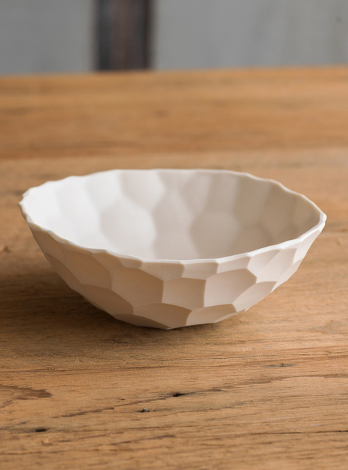

Hi,
I’m trying to get a similar effect as the attached image. Is there any way to make the transition between each dimple sharper? Right now, I am using a standard brush to create the effect.
Ivan

I know that I can use the pinch tool, but I’m trying to find a less laborious solution.
try polish brush
Try running Geometry>ClayPolish +using a record layer to increase edge detail
perhaps also try Deformation>smooth in the negative direction.
Similarly to recording with layers and using a recorded layer slider - morph target sliders are a good way to enhance details

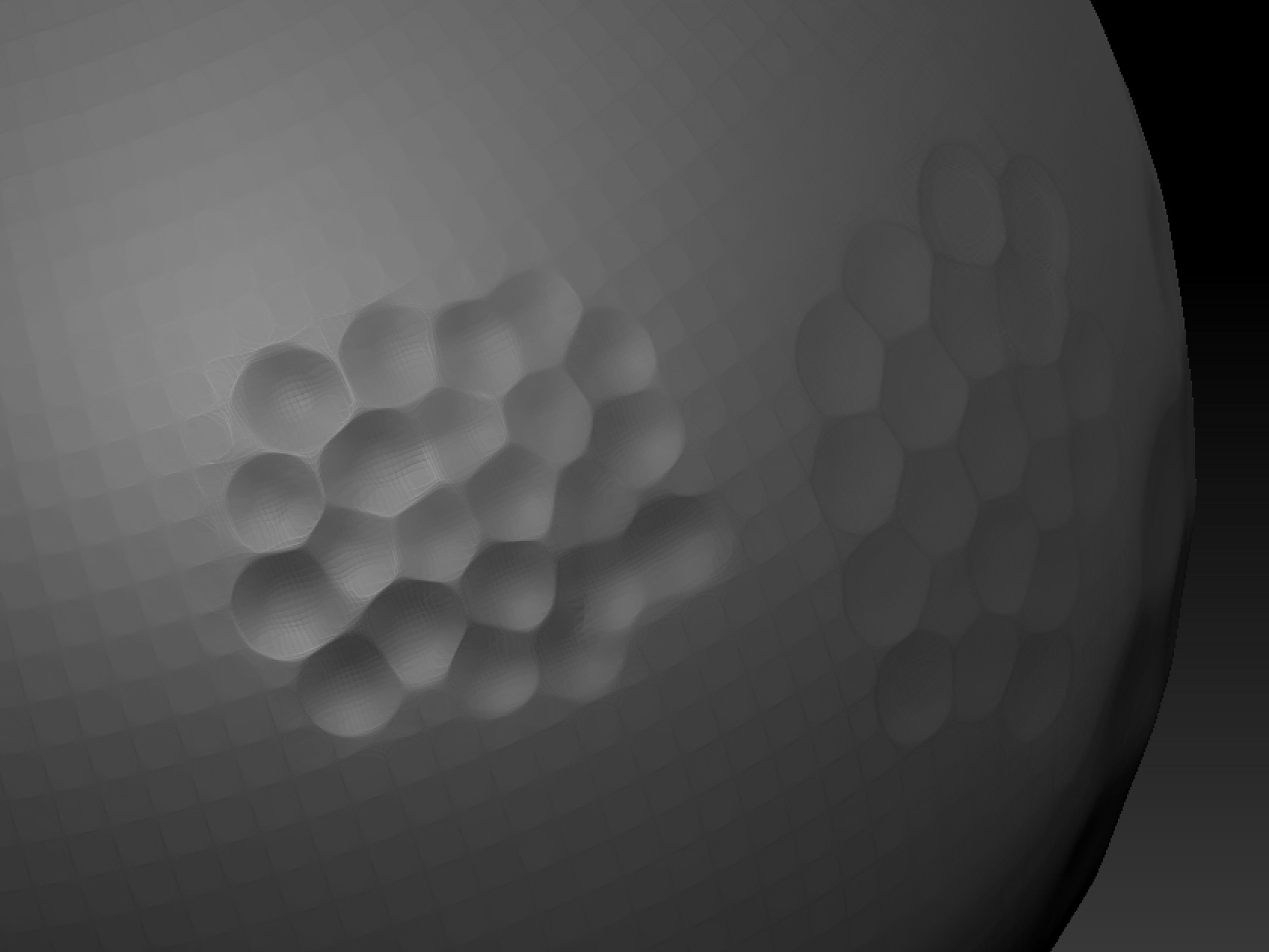

Thanks guys, I think boozy floozie’s method of playing around with Clay Polish works best:
