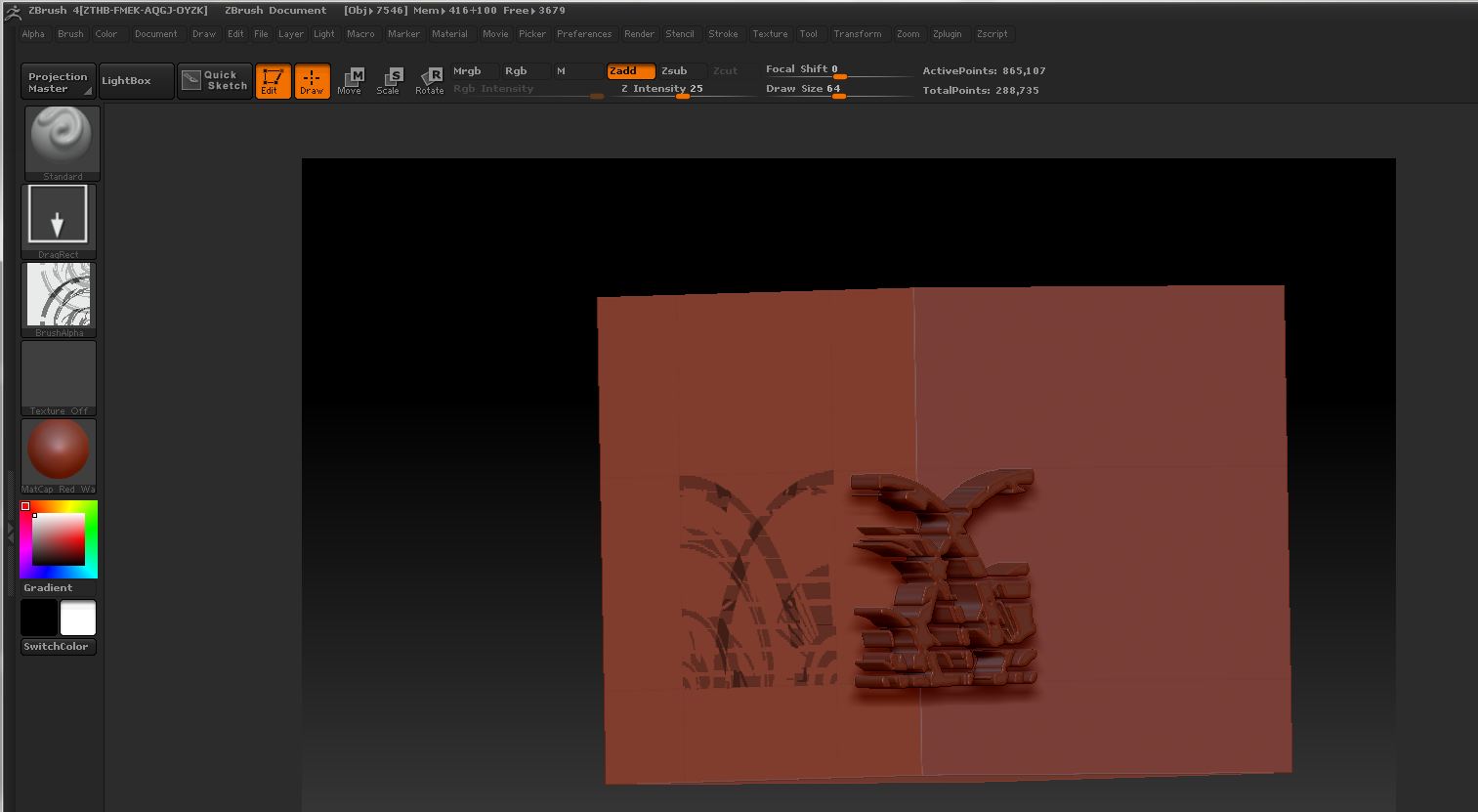

I imported an alpha and reversed it under the alpha tools - when I try to to use it with the masking pen brush in shadowbox it reverts back to the unreversed version of the alpha. What am I doing wrong?

Marcus that helped with the res - I did find out by trying this - (reverse alpha from alpha tools while holding ctrl down in the shadowbox) the reverse alpha from alpha tools does not activate when clicked upon when in the shadowbox ctrl mode of masking rect drag box. So is the way I found the correct way or should the reg reverse alpha activate when in the masking rect drag box when clicked upon?
The image shows a reg alpha which I reversed as stated above to get it to work in ShadowBox
The alpha when reversed in the reg way will not activate when I go to alphas in ShadowBox but when I use the ctrl and then reverse the alpha it works
Is that the correct way.

Marcus when I create a reverse from my alpha and ctrl to use it it does not work
So I am trying to find out why the reverse alpha created before going to ctrl does not work - It does show up when in ctrl but does not active.
If the alphas have to be reversed while in ctrl OK I do this

ctrl > slect the alpha > go to alpha tools and reverse alpha > select the reverse alpha
But if the reverse alpha before going into ShadowBox ctrl mode should work it is not - it keeps taking me to the unreversed alpha.
So if reverse alpha has to be made while in ctrl mode I can not find it documented. Which means it may be a bug - but if the reverse alphas are to be made while in ctrl mode of ShadowBox then not.
Should either way work?
