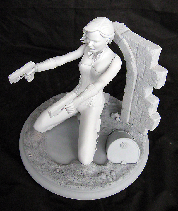

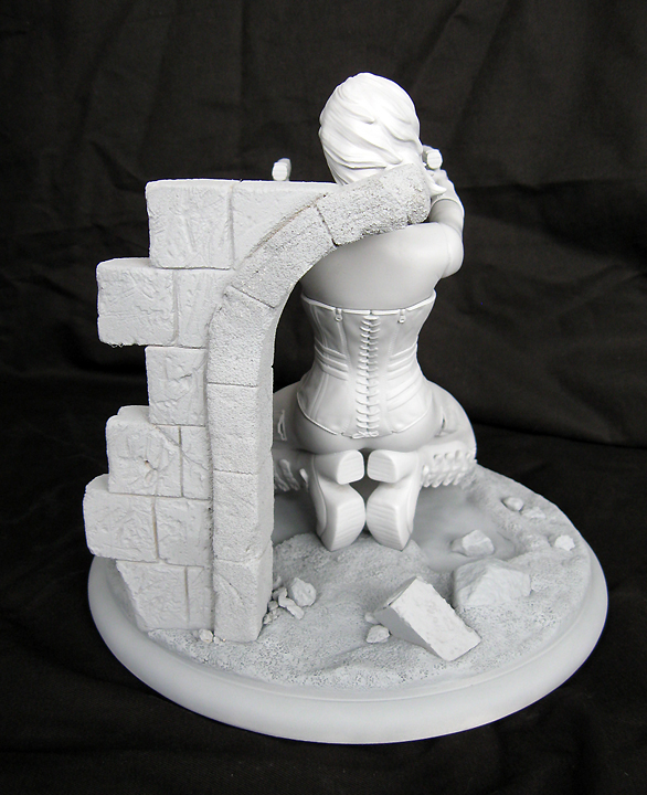

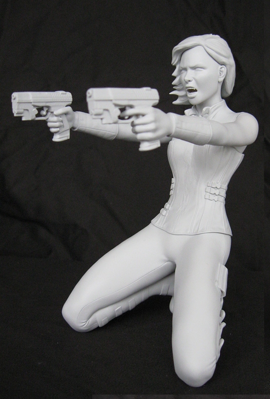

Sweetness. Grat’s man, it looks great!
Realy cool one ! This is a piece i’d like to see on my shelf !!
Awesome! I really like this piece, and thanks for showing the print and how all that worked out. Great job on all those details too.
nice one!

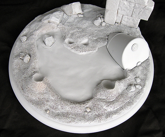

shame the splashes from the falling bulletshells arent in the water of the figurine though… when i saw the first pics i thought “how cool would it be to paint those watery in a print”.
Looks great. Really nice to to see it printed too.

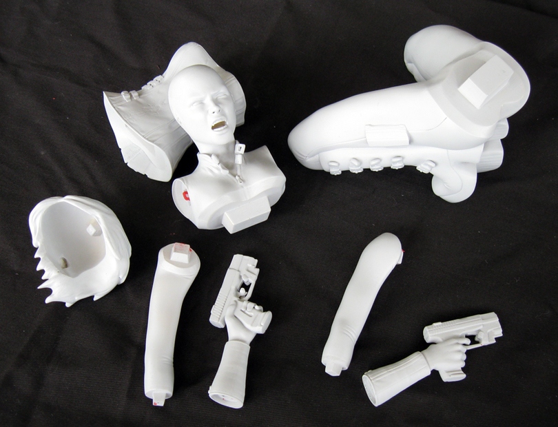

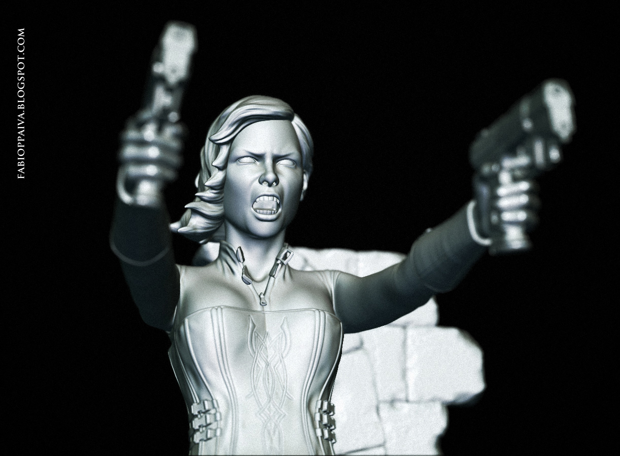

Would you mind if I ask you a couple of questions?
Particularly, your sculpt looks mainly one piece (body, arms etc), did you separate the parts? or did he? If so, how was it done?
Also, the hair is obvioulsy a seperate subtool, but did you sulpt it to fit onto the head, or did he? and again, if so how?
I have been doing a couple of these, and sculpting in ZBrush to make sure you have bits that join up seems really difficult.

Looks awesome Fabio, do you decide where the body splits will be, or did the printing company split it up? Just curious how the process works

Gunnahan, Thanks! And yea… I really liked the splashes too

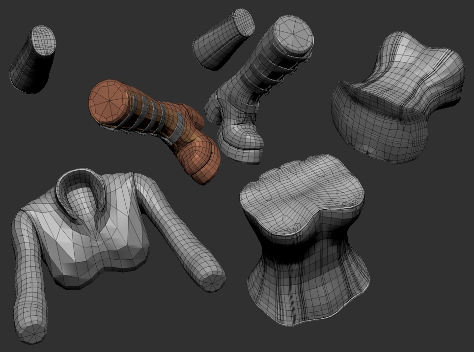

TrevorJ/Gordon Robb, Thanks for dropping by! I´ve modeled everything in the way we all do. Lot´s of subtools and most of the meshes are inside one another. The only thing that I double check is to not leave any open holes. If you want you can use two programs later for the cutting operations: MeshLab and Magics (one for STL export and the other for the boolean operations).
Please take a look at the image I´ve attached. Kinda messy but… all closed! I don´t really know if that´s really a need nowadays, but I once read it was… so…
So, after a few days trying to make the right cuts and finally getting it to work, I found out that the guys at ownage would do that for free. hahah :rolleyes:

That’s cool thanks. I’m particularly interested inthe hair. Was that modelled to fit the head or did you haveh it overlapping geometry and they boo leaned it
Yea, the hair overlaps the head mesh and they´re booleaned just like all the other pieces!
