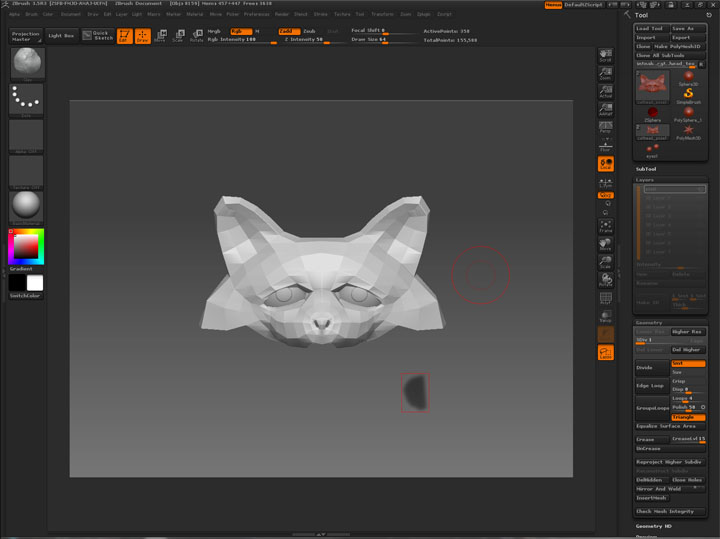

When I do a hide selection I keep getting this red box, and it seems to mask my whole screen. I can’t remove it. Can anyone help solve this problem?
Switch off Stencil Mode!!!
Thanks dsoellbuster for the quick response. That was driving me crazy.
