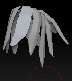

Seeking assistance with applying thickness to a "sheet" of polygons
I have constructed a rough and simple 600 poly leather plated skirt for a sculpt and I need to find a way to bulk out the mesh for sculpting (it’s dynamesh, holes filled and when re-meshed goes to 2 million polys?!).
I have tried doing a mesh extraction in the hopes that it would build a case around it, but it just keeps the same thickness to the garb but just further away from the base.
Anyone have any ideas on a possible solution?
create a morph target, do an small push/inflate deformation, then create a difference mesh.
Button is found in the morph target palette I believe.
That would be how I would do it, although I believe you could do it with Panel loops too.
