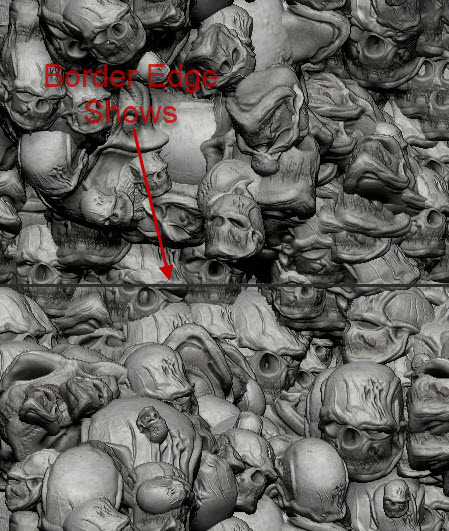

But i am having problems trying to do this now.
I have tried everything i know to do but there is a
border that shows up everytime i try to capture the doc.
Can someone please tell me why GrabDoc/MRGBZgrabber
is leaving me with this nasty border…
Thanks so much in advance…

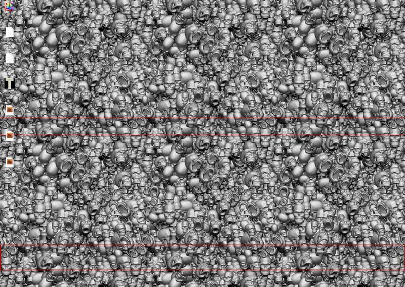

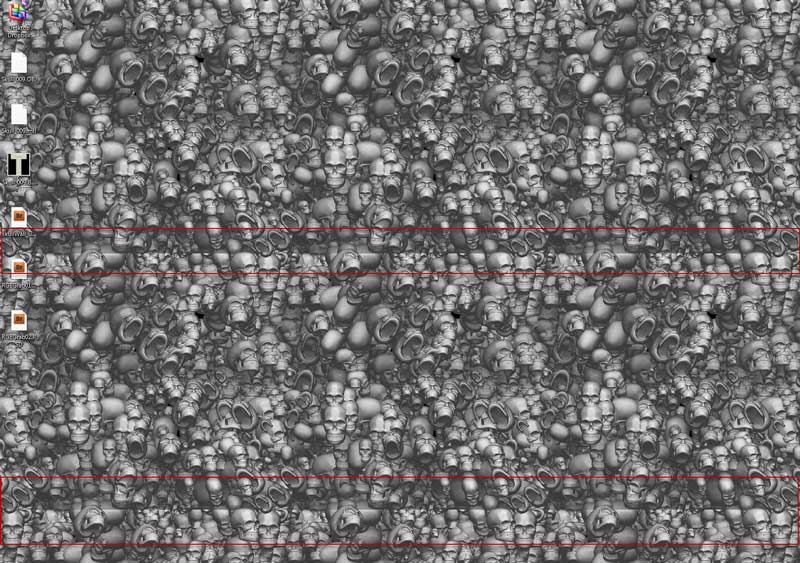

I have tried using MRGBZgrabber or Grabdoc from texture palette.

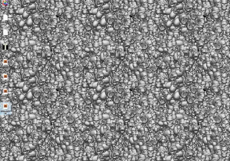

Then i set the image as a desktop background “tiles”.
The only way i can get this to be seamless is to turn shadows completely off.
Shaded without rendering…

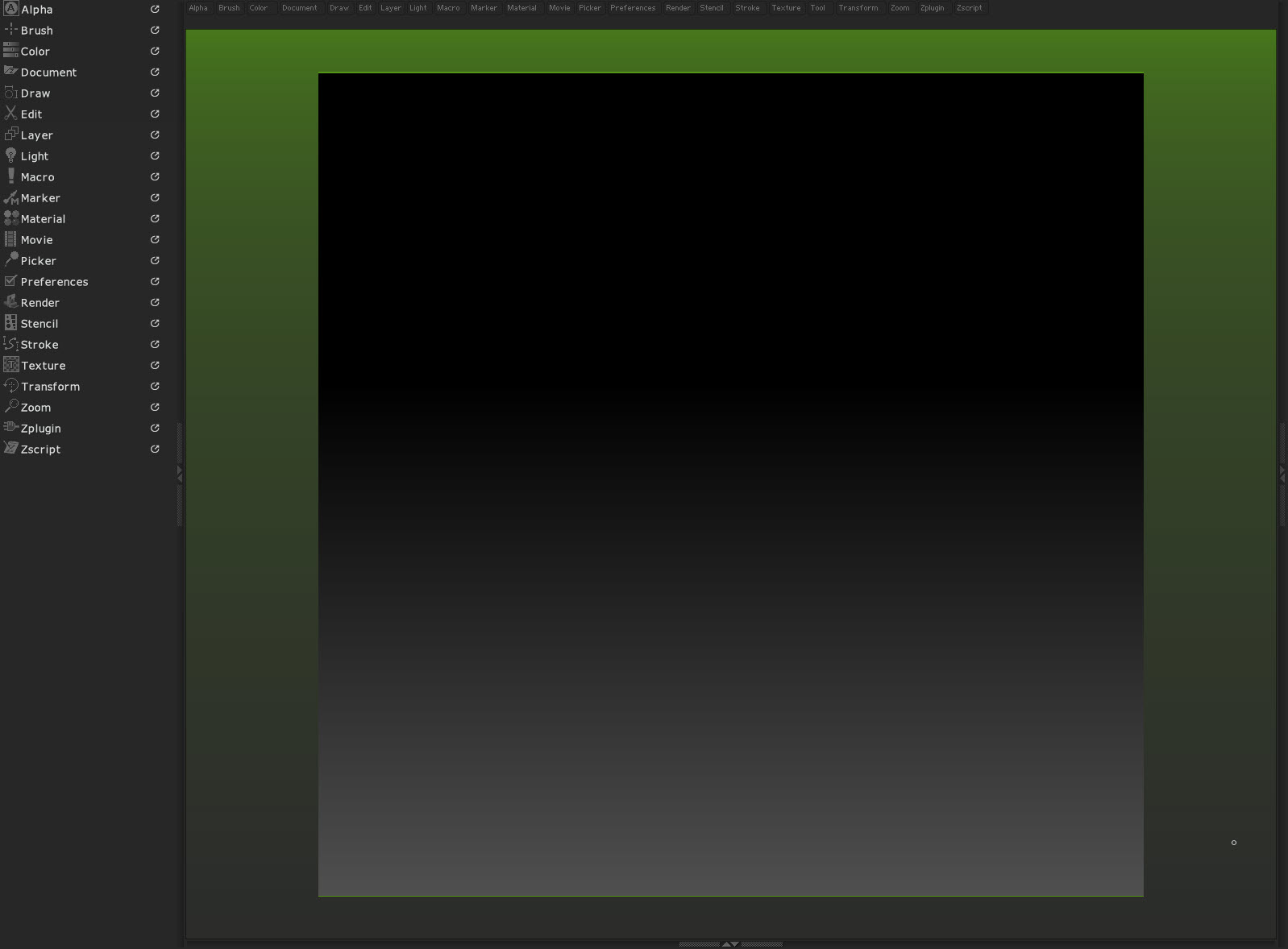

Hey, thanks for trying to help.
But i still am having this same issue no matter what i do to the light.
I have been trying my best to locate where the issue is coming from
so i can be sure it’s not something stupid i am doing to cause it.
I noticed that by changing the borderColor1 to anything other than
the default will reveal this strange borderEdge as shown in the screenshot
below. Zbrush lights seem to have no effect on this borderEdge. Grabdoc
and MRGBZ Grabber both capture this edge.
Best Render makes this borderEgde disappear but GrabDoc &
MRGBZ Grabber still captures the identical looking edges.
Please any input is greatly appreciated.
