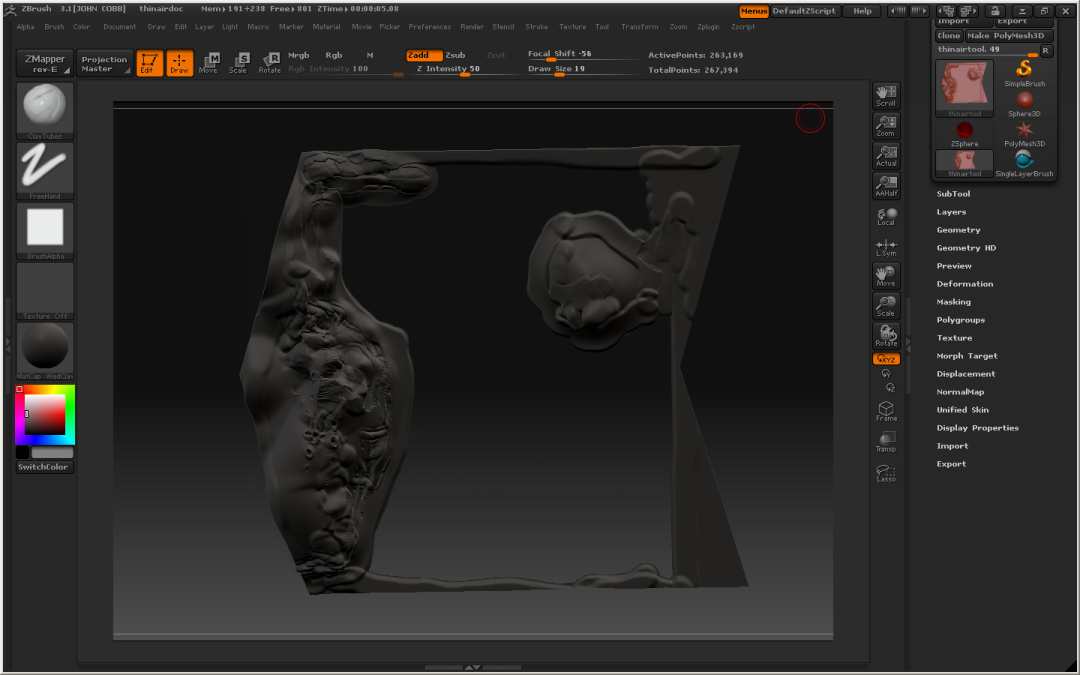

But is there anyway to get rid of the border?
-Zbrush newb.
Thanks, ancomic!
Thanks, Jesse.Aitui! To make the border disappear you can select the second subtool (the transparent plane hiding the one you’re sculpting) and increase the Deformation slider for Size (Tool>Deformation>Size).

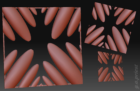

Made a zscript showing how to change the square into abstract shapes. First zb3.1 zsrcipt so I hope it works - works on my zb.3.1
