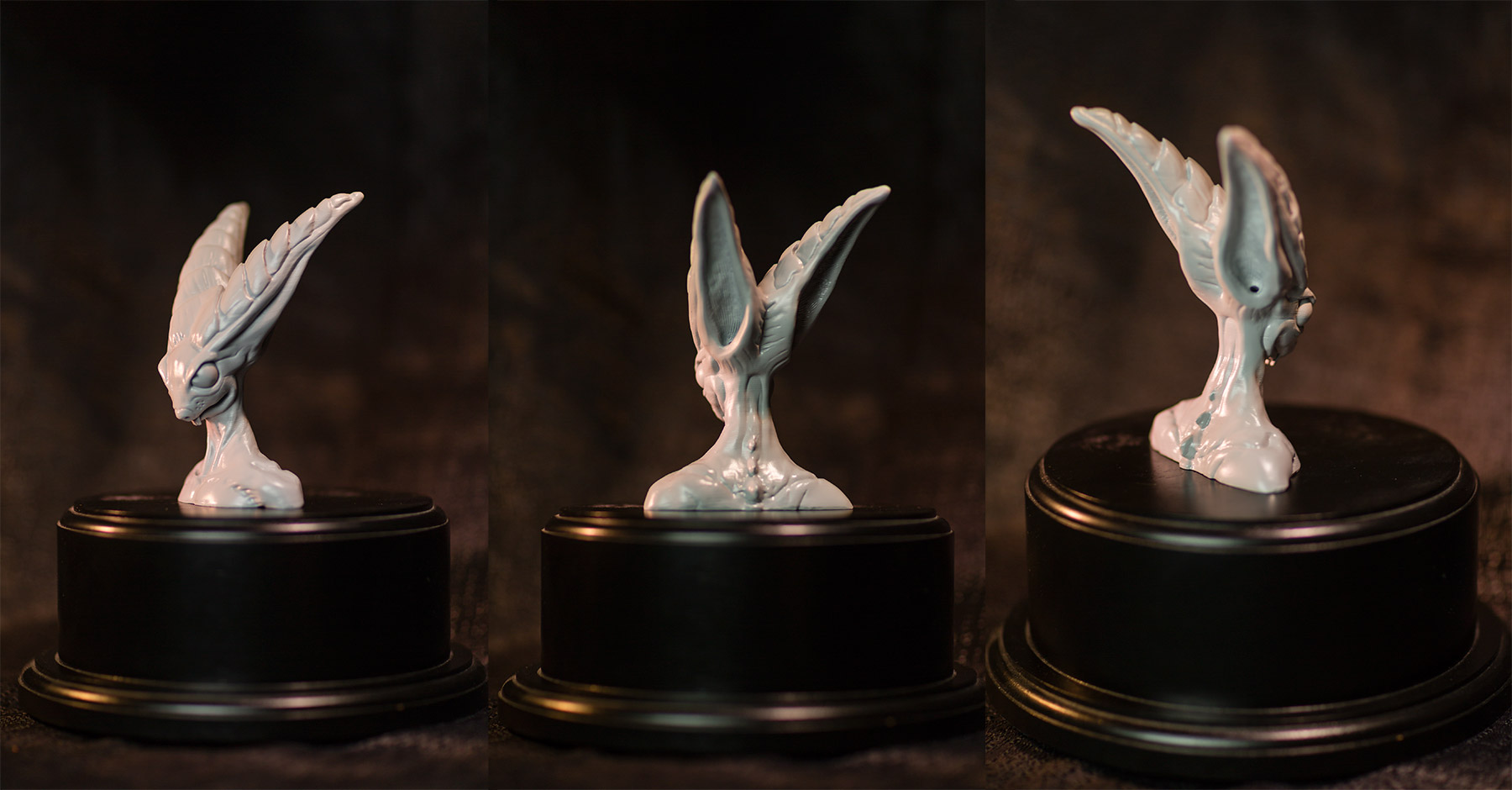

Oh excellent, thank-you . I hate to keep bothering folks but since you have a printer, it might help me to ask. I am trying to find out whether I should use extractions for clothing when printing a figure or whether sculpted detail on to the base mesh works just as well? did this model use extraction for the clothing? if so what were the settings if you don’t mind? --many thanks--
@ TIM-OSULLIVAN: the best is to minimize the number of SubTool. In my case, I merge everything and create a single DynaMesh. Then I split it and hollowed it.
On this specific model, the clothes has been sculpted directly on the mesh, except some small details, which has been merged at the end.
cheers for that!
very helpful. I wasn’t sure if you could sculpt detail on to the mesh so that’s good. many thanks--
What is important about the details is to increase their volume, I mean the printing process will erode them a little bit, then you need to compensate on sculpting time.

This thread more than anything else I’ve seen has made me consider buying one, you mention needing lots of spares, how many trays have you used? How many prints per tray?
Also would you mind sharing your techniques for how you prepare the model for printing? I’ve not seen many people having great success like this.
Thanks.
I discussed with them about the resellers. Don’t forget that it’s a young company and they still need to send the printers to the kickstarter “pledgers”… then after catch the train with all the printers which have been ordered since the end of the KS campaign…
I’m sure they will create a more “international” business as soon as it will be possible for them. And I’m the first one looking for that since I’m located in France.
For the spares, it depends totally of the type of models you are printing: bigs or small ones. But to be safe, one resin tank per 2 or 3 liters of resin. And it’s better to have one rein tank per type of resin, to be sure to always have the same resin in the same tank.

Hi Totyo, I’ve just started using zbrush with the aim of making my own figures, can i just confirm did you use this printer to make that figure, the details very impressive, just what I’m looking for. I don’t suppose you tell me roughly what material were costs where like also?
http://formlabs.com/products/our-printer
awesome character sculpting by the way!
Yes, it’s the Form1 3D Printer from the link you posted that I own and which is able to produce such details.
For this model, the cost is approximatly 51 euros, but you can’t convert the price to dollars since the printer cost as well as resin and IPA are more expensive when you are located in europe (more taxes and shipping is far more expensive…) Then I guess the same print could be approximately $50. If you add the legs (I need to post a photo…), the price would be 75 euros (the height of the print is 32 cms).

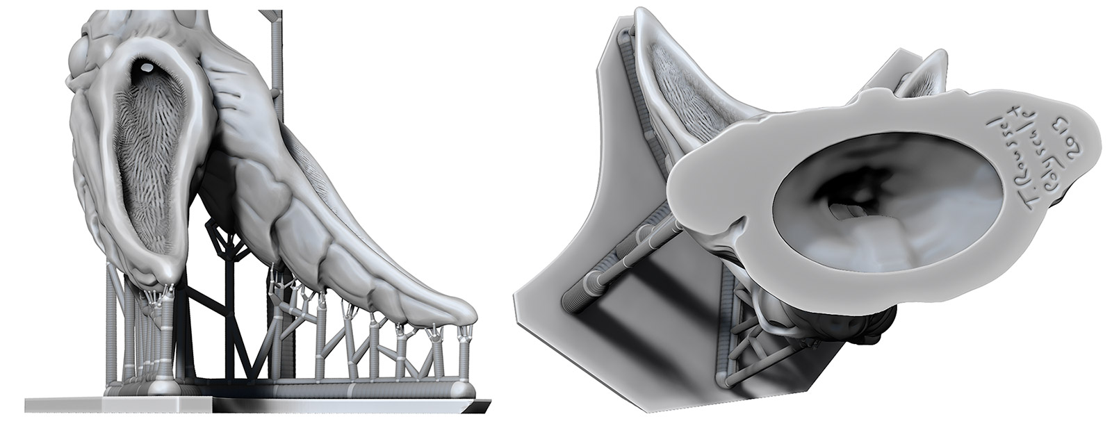

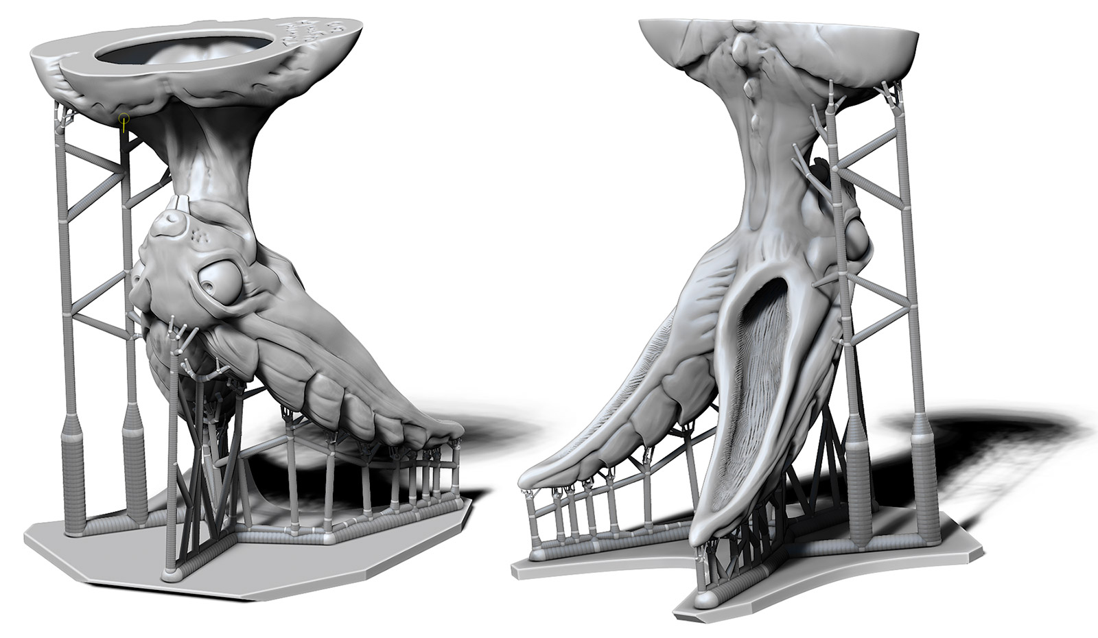

Some recent projects involving ZBrush and 3D Printing. I’m using ZBrush to create my model, but also to prepare it for 3D Printing, by hollowing the models and reduce the cost of material (and printing time), but also doing my custom supports using ZSpheres.

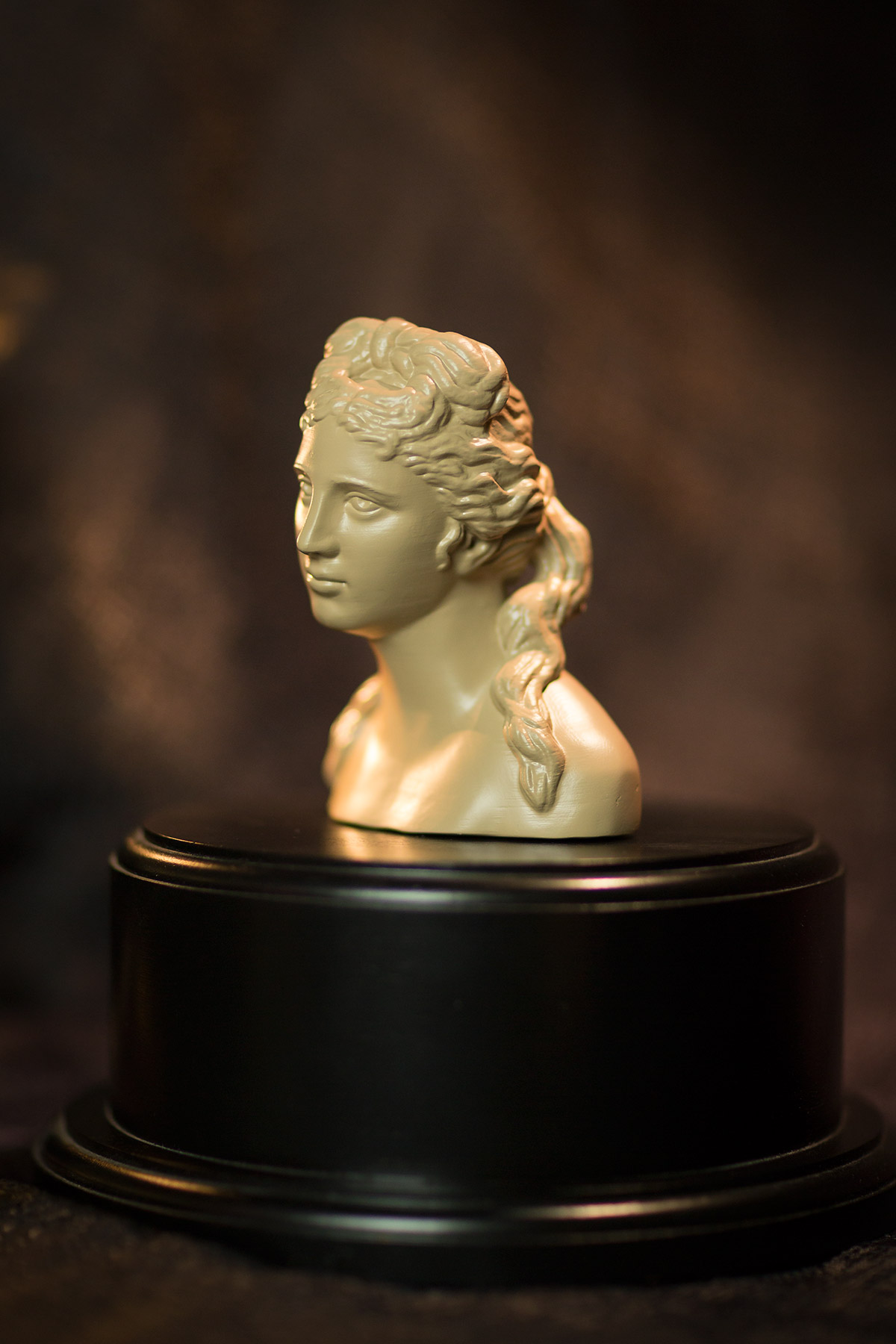

I also printed an old model that I never had the opportunity to have for myself, the Venus head I helped to reconstruct few years ago. Funny to see the Real to virtual through scan, then back to real through 3D Printing! I also did some custom supports for this model:
Both models printed in 50 microns.

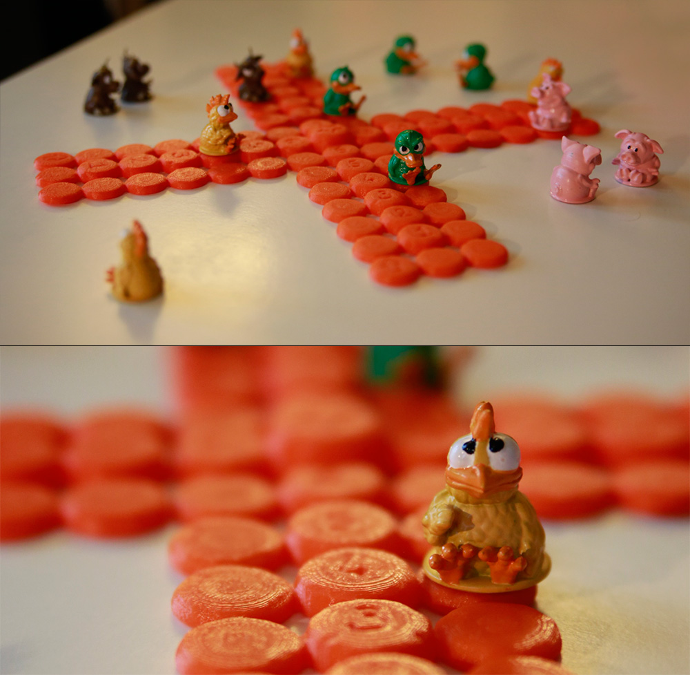

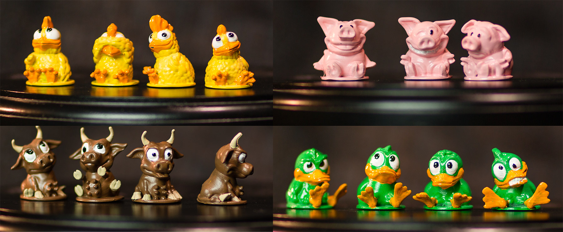

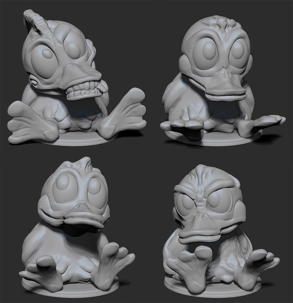

Another project I’m working on is a little french board game to play with my family, inspired by the game “The little Horse” (approximate translation) or more well know in the US under the name “parcheesi”. But I wanted something more unique and thanks to 3D printing, I created the “Little Farm” where each player have 4 unique pieces in each categories: duck, chicken, cow and pig.
Here are some screenshots and photos of the collection. The pieces has been printed in 25 microns on a Form1, then hand painted. I still need to finish some painting since I did it really quickly. The board is in progress, printed on a Replicator 2.
For ZBrush, it has been really easy, everything in DynaMesh, mixing some insert brushes and few brush strokes.
