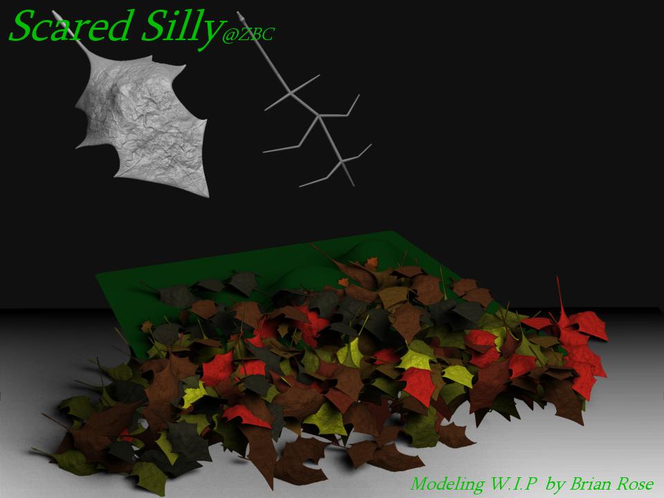

Hello! I just wanted to show a small test I’m working on for the ground cover of my illustration. I created a single leaf for this example. I changed the colors and used the draw rectangle and rotate dot strokes for this. The green plane in the middle was part of a shadow test for an idea I have.
The far upper left shows the sculpted leaf, and just to the right is it’s Zsphere. This was also an exercise for me to see how well the 2.5D brushes are working in ZB3.1…I need some practice to say the least! 121 most welcome!
Great techique for making leaves. Looking forward to seeing this one come together!
I need to calibrate my monitors again…:evil: :mad: this image is much darker than on my work box. The BG should be set at Zbrush’s default background gradient color of .66 not black as it’s displayed here. If anyone would be so kind…please tell me if my background is closer to black…which I assume it is, than it closer to gray. I just had to install C&C 3 Tiberium wars on my work box…now did’nt I.
On my end the bg looks around the 75-85% grey. i love the leaves you did, i still have no idea how you did it :S, even reading what you said, haha, im thinking some blueish/purple tones would be good with some hints of yellow and black. but thats me
great work so far,
Thanks Mark and Michael! Here is a quick tutorial on how I created this image: (Keep in mind you can use this same technique for any objectyou use in a scene.) NOTE- If you already have an object skip to step #4.
- Create a Zsphere model of the leaf.
- Convert it to a polymesh 3D and add the detail.
- I did not use the polypaint feature on this model, but if you wanted, now would be the appropriate time.
- The final step is to select the tool you just created and then click the ,“stroke” tab, and select your stroke type. This is where I need some practice, because the stroke options I remember don’t seem to work the same as in ZB 2.0.
- Start painting!
Here is a little bit more detail…:eek:
You will essentialy be painting the leaves onto the canvas. With your object selected, open the,“Picker” pallet, it will allow you to rotate the tool in order to properly align it in your scene…but there are even better options…
The stroke pallet tab allows you to select different ways Zbrush draws the object you have selected onto the canvas. I was using the Rotatedot, Dragdot, and drag rectangle. Please keep in mind though that even though my BG scene looks similar to the default start canvas, it does contain depth info…allowing the shadows to be cast by the leaves. I hope this helps some any questions just let me know!
Looking good! Those leaves look really nice.
Thank you Marsyas! I’m just starting to start sculpting the ground for my scene. Hopefully I can have some work up soon!
darn good use of z-spheres here! I like the leaves
