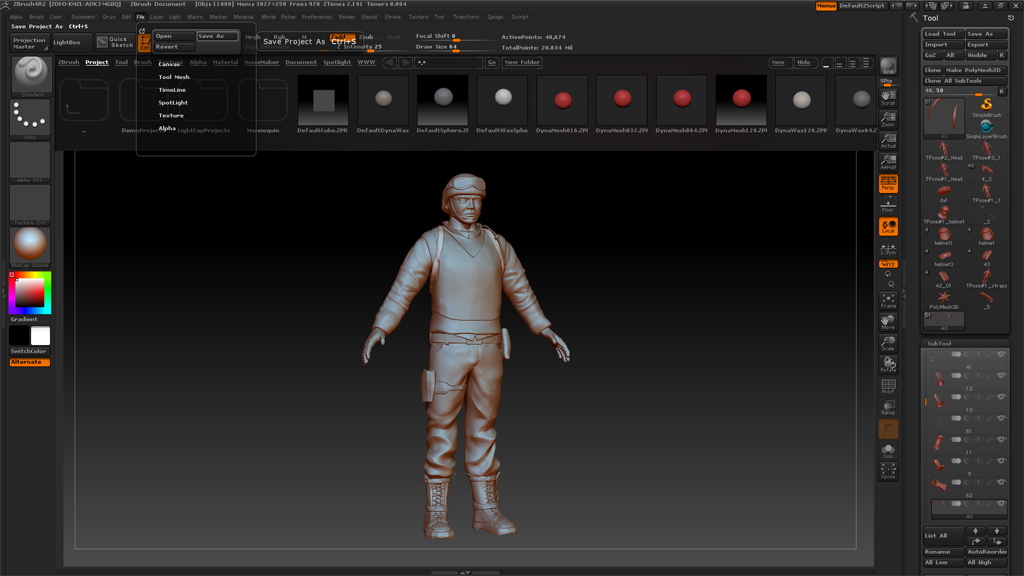

Screenshot (right before saving, then closing):
Out of curiosity, how large is the ZPR file? How many total polygons do you have between the various models?
Also, is there a reason you’re doing separate models rather than a single one with SubTools, which you can then save via the ZTL format instead of ZPR? The thing about ZPR is that it saves pretty much everything. While that has advantages in some situations, it also has disadvantages in others because it can save data that you don’t need to keep from session to session. This increases the size of the file, opening the door for you to run up against the 4 GB wall.
