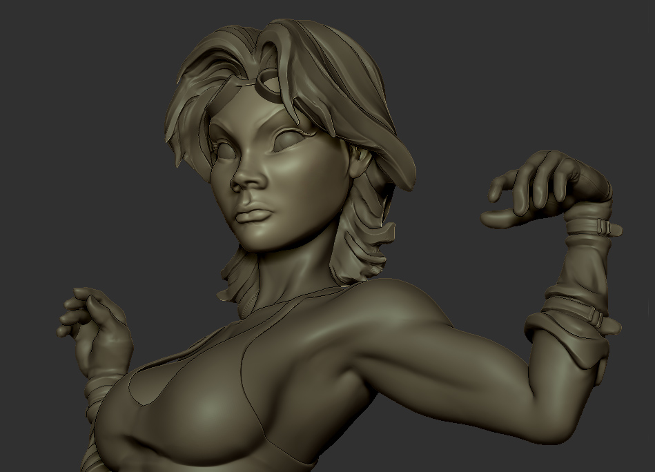

Savage Beauty
I like the hair and your style a lot. Nice form.
Here is a peak of my DG Abby wip.
Looking really good!
wow! i didnt even see the whole thread…that savage beauty piece is jaw dropping! pure awesome!

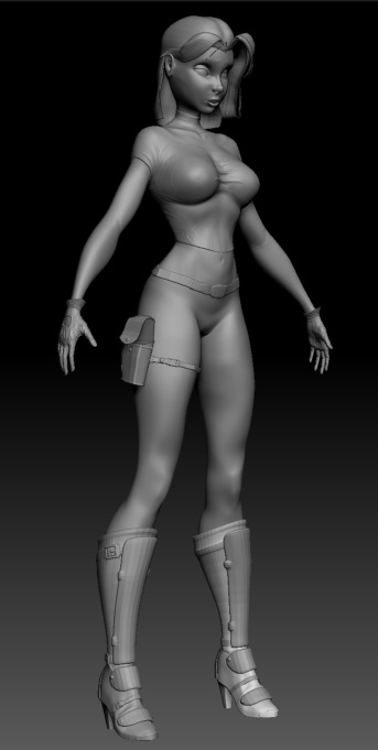

Gseaman3D: Okay here is the cheek cleanup may not be spot on but I can live with it:) fixed a few other areas too. Mainly wanted to capture the likeness. I’m done with this one, have a few more characters I want to do. thanks for the crit.
yah the cheek looks much tighter as the concept implies. And yes it is livable with now haha looking forward to your next model
Great work buddy! Can’t wait to see what you do next. :smiley:

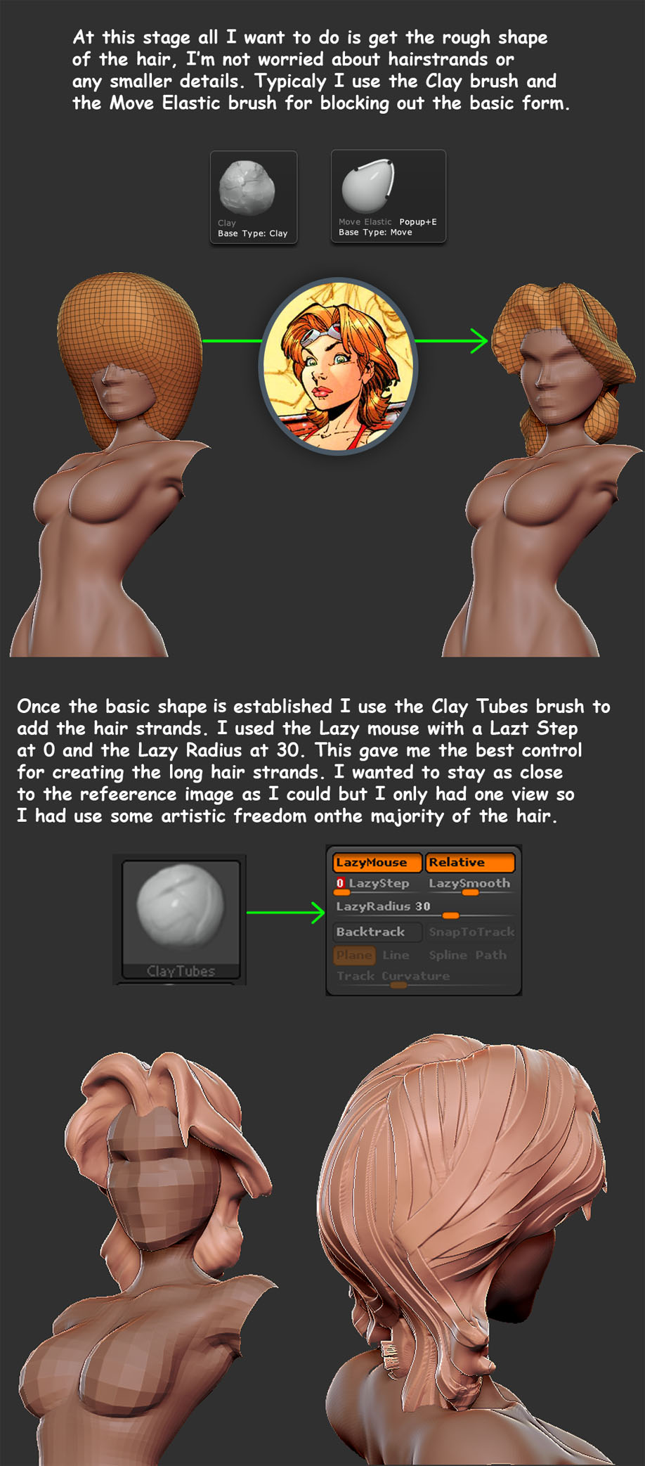

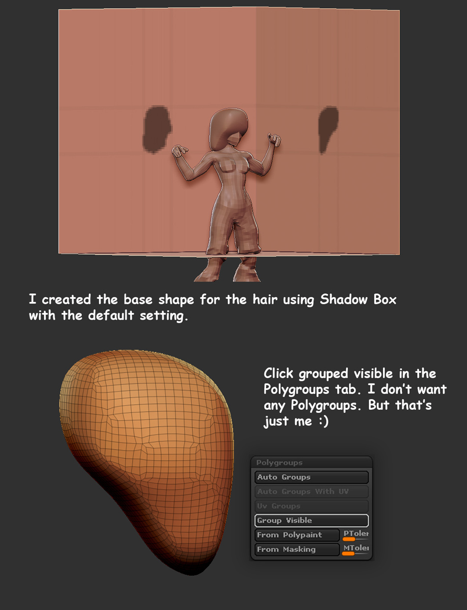

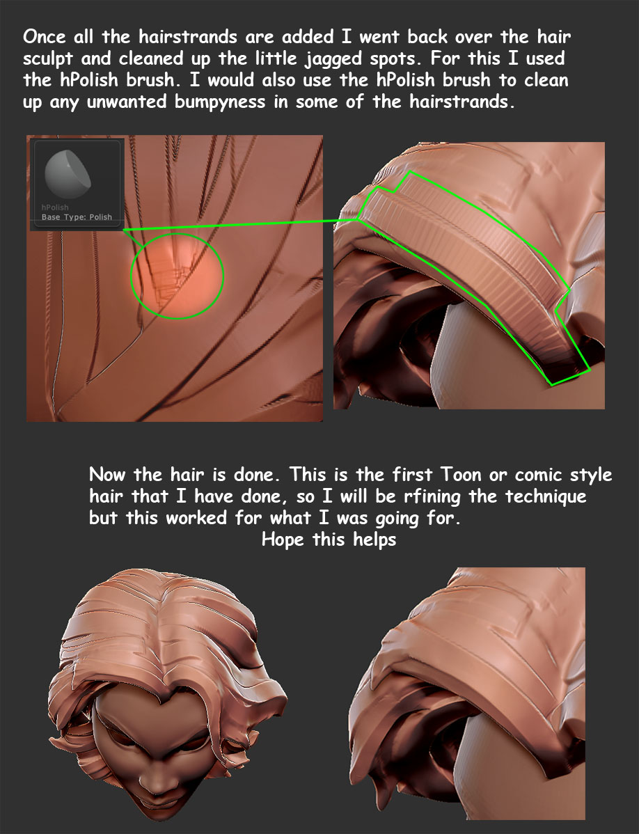

asecbrush:
Here is a quick run through of how I created the hair for the Danger Girl piece.
Hope this helps.
[attach=218779]HairSculpt_01.jpg[/attach]
[attach=218780]HairSculpt_02.jpg[/attach]
[attach=218781]HairSculpt_03.jpg[/attach]
Very nice write up! Thanks bud!
