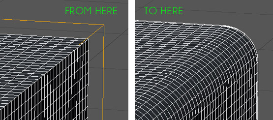

just to know is ther is a brush … to rounding an edge.
for example… i have a cube … and i need rounding
i place a picture below what i need .
thansk so much any help

Have you tried looking under the Deformation toolbox? perhaps spherize of inflatespherize ?
nice thanks…
but … spherize … apply to all object edges …
and I just need on a single edge of an object …
is ther a way to select one edge to apply spherize ?
mask off everything but one edge then smooth, polish, relax, from deformation palette.
You can also use your transform gizmo… If you have scale, move or rotate selected, click on the gear icon on the left that appears above the gizmo…
this will bring up the transform type popup menu.
Select Soft Deformer.
You should then see a lattice surround you mesh with something that looks similar to the gizmo with red, green and blue cones.
Pull the different green, blue or red cones to add selection points to your lattice.
Once you have enough selection points, you can then select the points you want to move by clicking on them. To move multiple points at once, hold shift and click on more point.
there should a a ghosted gizmo over the last point you selected… you can then move those points with it and see how it effects your model.
Once you have created the shape you wanted. click on the gear again and click accept.
