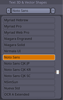

Hey guys, i 'd like to know how to reproduce the rollover menu from the Text 3D and Vector shapes Zplugin , is there anything new in R8 Zscript ?
Nicolas
Nicolas
At the moment, this isn’t possible. There are no new zscript commands apart from the change to IKeyPress mentioned in the thread above.
i don’t understand the logic of this, really, its not possible, but the menu is real. so what the point ?
it’s a note interface that popup just under the pointer ?
The menu is hard-coded into ZBrush and it’s not available to zscript.
ha ok i hadn’t thought about that possibility ^^
thx you for all the detail on that topic so i don’t continue to mind how i could reproduce this type of menu
it’s still possible to make a note interface instead and choose the option from a list.
