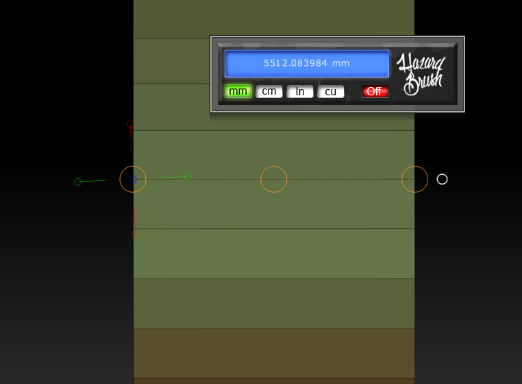

I created a ring in ringmaster. Set it to a size 7 with a thickness and width of 1.5mm square
create the basemesh.
Pulled out caliper master and measured the width in mm. It was astronomical ! Not sure what is going on. Tried it twice with the same result.
Can anyone give me a heads up on whats happening ?

@Foxjaw: Sorry to hear about your troubles with this. As long as you press ‘Enter’ after typing in the desired values in the Ring Master it should generate the correct scale. ][-][4Z4R][)) here on ZBC is the author of Calipers Master he would have more information for you on how to get the transpose options setup there.
