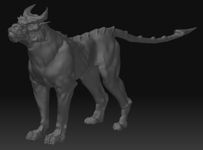

Reversed perspective?
I don’t know how this happened, I assume that I hit a button somewhere. The depth seems to be reversed. The model’s back foot (the one farthest away from the camera) is larger than the closer one. But they are the same size. Anyone have an idea how to correct this? Any suggestions are very much appreciated.
I think you post in the wrong place, and this is why nobody answered to you.
I don’t think you can have a reversed perspectve unless you distort the object itself, :smiley:
in your case looks like an orthographic view, and in this angle you can have that illusion
try: Draw Pallette-perspe button, you can also adjust the focal length.
