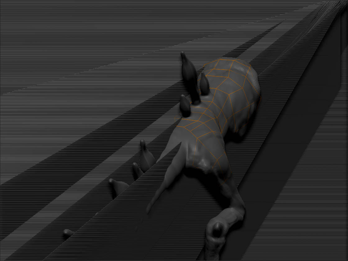

Hey! First time retopologiziing a full character, and immediately hit the wall. When I st up the adaptive skin density and turn on projection and then press “A” I get this instead of the details. Can someone please help me?
[[attach=181519]01.jpg[/attach]](javascript:zb_insimg(‘181519’,‘01.jpg’,1,0))
[[attach=181520]02.jpg[/attach]](javascript:zb_insimg(‘181520’,‘02.jpg’,1,0))
Try setting Tool>SubTool>PABlur to 8.
Aurick, you’re the man! :slight_smile: Thanks immensely!

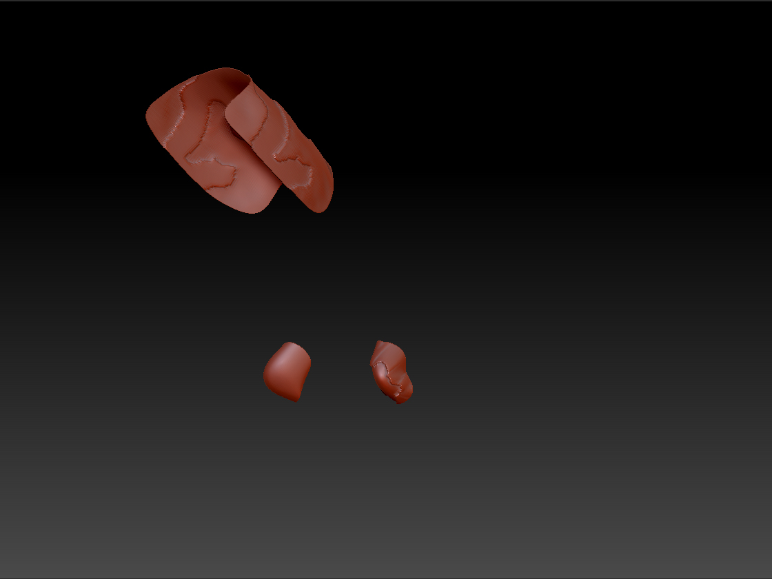

I have another problem now though, when I turn around my model whendoing the retopo there are some angles that are really buggy and don’t let me to see and work. Any solution to this problem?
ps I’m working in 3.5 r3 if that means anything
[[attach=181619]bug.jpg[/attach]](javascript:zb_insimg(‘181619’,‘bug.jpg’,1,0))
Hey, I figured it out, it was due to perspective turnd on, I turned it off and it’s now ok. Thanks!
