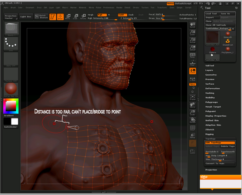

The issue that I’ve run into seems to stem from a scale discrepancy. Although the mesh in 3ds Max wasn’t extraordinarily large, it appears to be quite huge in ZBrush. I didn’t think it was that big of a deal as I sculpted, but now I’ve come across the delightful realization that it is. While attempting to build the new topology of the mesh, I’ve found that I’m restricted by how long the bridges can be between any new vertex points that I place. I’m assuming there’s some sort of upper bound when you’re editing topology and Zbrush won’t bridge between two points when you go beyond that?

Here’s a photo to try to demonstrate. When I try to place a point it won’t let me. Zbrush_Prob_Demonstration.jpg
hmm…never seen that one before.
You can scale down the model that you’re working on and try from there to see if that will correct the problem. Granted…this only kind of fixes the problem.
You can maintain all of your current topo by making an adaptive skin of it. append that into your mesh before you scale it.
use transpose master to scale down both of the meshes together
then finish transpose master.
clone your new scaled down topo into a new tool by itself.
start your topo with a Zsphere, and then load the current topo you had into the topology tab and you should be able to continue from there.
