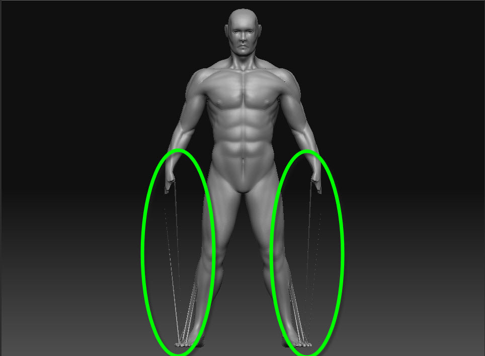

retopology problem
when i retopologized and made the adaptive skin it was like this …a mess:confused:

Hi agrmrs
It’s a classic retopo issue. You ‘have’ checked out the topo’ lab thread
at:
http://www.zbrushcentral.com/zbc/showthread.php?t=44876
right?
In your case it looks like problems with the fingers and toes. Is your base
mesh there four-sided (rectangular cross section) perhaps?
Other than that, I’d look in those areas for micro-zsphere ‘connections’
that have ‘missed’. It’s very easy to do when you have to get in tight
around small features, and it’s usually the problem for me.
(In ‘move’ mode try moving vertex zspheres slightly. You should be able
to spot if any edges have crossed over rather than connected.)
G.
