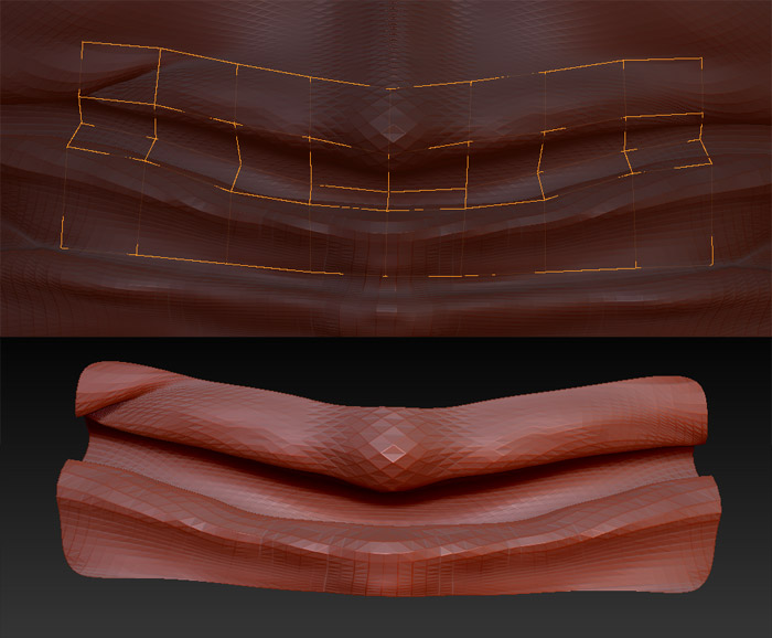

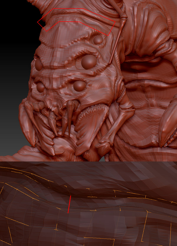

I’m having a slight problem retopologizing a mesh I’m working on. Trying to get more geometry in some areas.
The flatter parts are easy enough, but there are certain deep grooves in the model I can’t quite reach properly.
I tried first doing both sides and then try to connect them, but that didn’t work since they are often below an overhanging “cliff”.

Here’s two screenshots to illustrate the problem:

the brush size is constantly lowest possible. but the problem is not being able to reach points because they are beneath overhanging cliff like geometry, no matter how hard I zoom or tilt my model.

I figured it out. Thought I’d share here since I’ve found many solutions thanks to ZBC search engine myself :slight_smile:
Simply bridging like I initially tried failed, but placing a line down the groove tells it where the bottom is, and zbrush fills in the rest.
