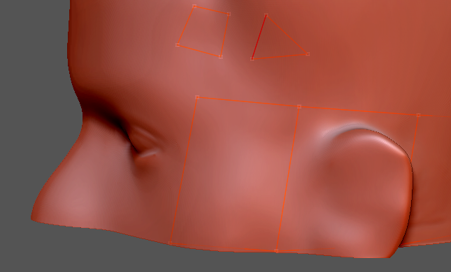

In ZSphere Topology mode, much of my earlier manual mesh vertices won’t move when I switch from draw to move mode. I have to make some dummy polygon and start moving one of its vertices and then often but not always my older vertices can be moved. It has nothing to do with the topology or any tiny extra lines or lack of connections up close since even very simple test polygons can’t be moved when this happens. Here I can move the lone rectangle corners but not the triangle or big quad mesh below.
I can use the normal Zbrush move brush when in ‘A’ adaptive mesh preview mode, if I set Dynamesh Resolution and Density of adaptive mesh to minimum, but the changes to the preview don’t get kept when I switch out of ‘A’ preview mode.
SOLVED: http://www.zbrushcentral.com/showthread.php?175569-Solved-New-to-the-Topology-Tool-Frozen-Points&highlight=zsphere+topology+move+can’t
It’s that masking via accidentally hitting control-A instead of ‘A’ masks all your topology mesh faces and only new faces will remain unmasked. But you can’t see any masking since topology only shows lines and doesn’t show masking in ‘A’ adaptive mesh preview either. Even in topology move mode you still have access to masking so you can control-drag outside the model and then everything is movable in move mode again.
