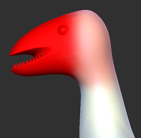

Here’s visualization of my problem:
http://i.imgur.com/Zmq3wut.png
Raising the adaptive slide will increase the difference of sizes in the faces to catch smaller details. Lowering will do the opposite.
Even raising adaptive size to the max (100) didn’t make any significant change, the teeth were still removed.

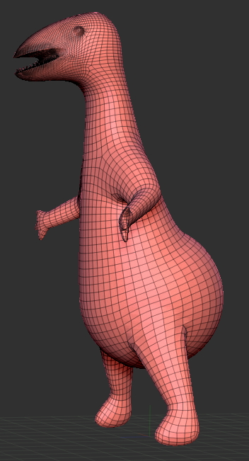

This is an example using default Zremesher settings with no changes and polypaint density 2X and 4X. Notice the gradients in the polypaint to avoid artifacts done with blurred masks.
14.000 polys. It looks also OK on at 8.000. If I want reduce the polys a lot more I would need to play also with blue colors for polypaint density.
Obviously your model could have specific problems that I don’t know but my only point is as a generic problem it can be solved. The last version of Zremesher is excellent. It is a good idea to use decimation master to reduce the number of polys before using the Zremesher to reduce the times and then be able to do multiple tests.
I think would help a lot if you do a bit thicker the teeth with the inflate brush, similar to the thickness I use. If the teeth are very thin it will increase the difficulty to detect the shape. You always can do the thinner later.
