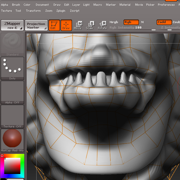

What is the workflow to Retopologizing teeths( see picture)
Is it possible to draw lines on my picture and upload it again?
Do you have video(or web link) about Retopologizing teeths or full body ?
