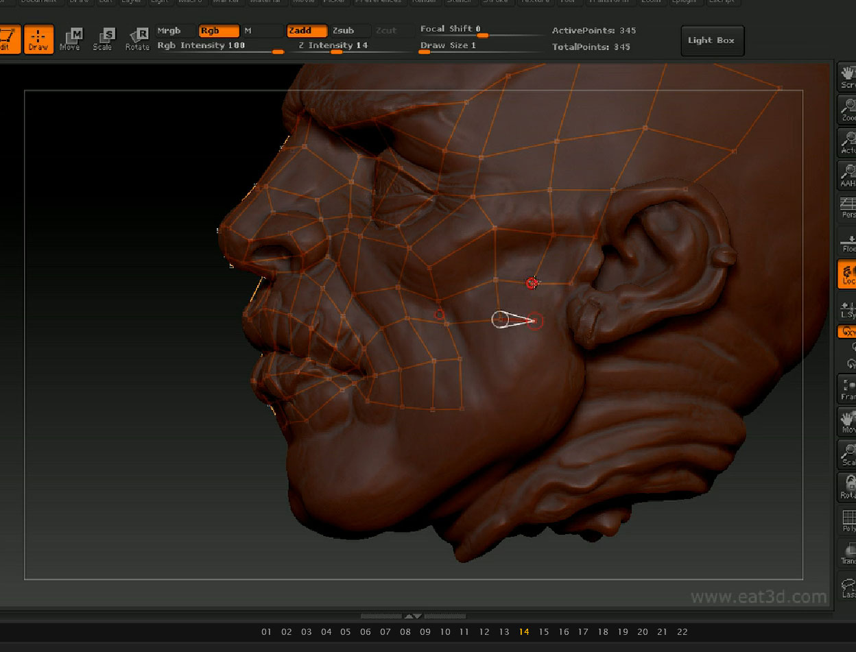

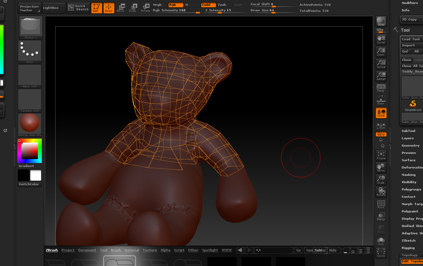

Hey everyone, I am trying to retopologize in ZBrush 4 and am having issues with the underlying mesh transparency. It’s extremely difficult to retop with a semi-transparent hi-res reference mesh. Anyone have any ideas how to correct this as I’ve seen a solid mesh be retopped before.
The first pic is my issue. The second is what I want to occur.

In Preferences > Draw change the Front Opacity slider to 1.

Try .5 in the Front Opacity slider value. This lets you see the hidden topo lines when they “sink” under the mesh like that.
If you don’t like the Appended ZSphere method of retopologizing and prefer the other way (Rigging > Select Mesh) then aurick suggested the following settings for front and back opacity in another thread which I think work quite well. (Thanks aurick).
Original pst by aurick.
In the Preferences>Draw menu there are sliders for front and back transparency. I get good results by adjusting Front to .95 and Back to .01

If you do as suggested above and set the Preferences>Draw>Front Opacity to 0.95 and Back Opacity to 0.01 then transparency isn’t a problem. Additionally if you select a dark color, such as blue, then the topology lines will show clearly where they are above or buried in the mesh.
