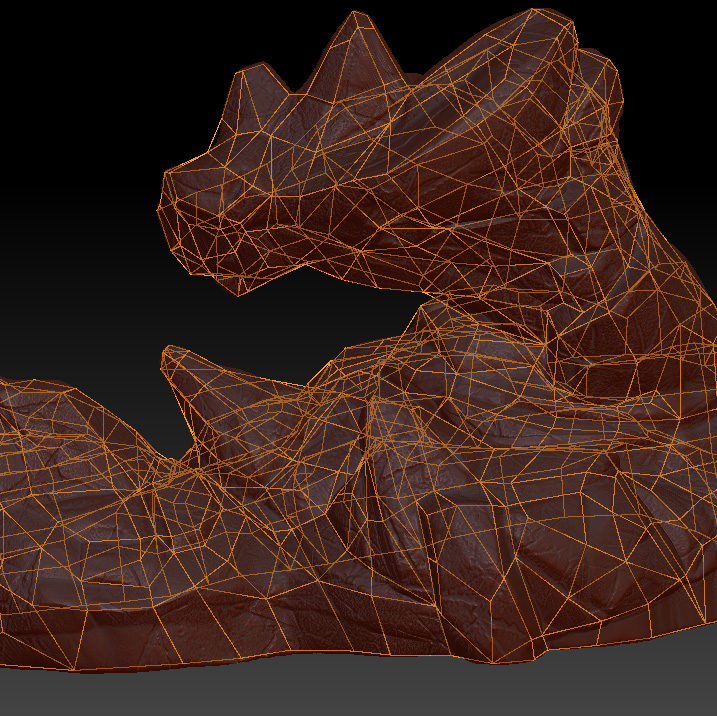

I can’t see the model because both sides of the retopolgy wire frame are showing at the same time. The model is not see through. This is making for finishing the retopo very very very difficult. can anyone help? I also exported both the low poly model and the high poly decimated version to Maya so I could finish the low poly and perform a normal map. When i exported to Maya it seems one of them has shrunk in size. They do not line up on top of one another and when repositioning them manually I see a scale issue. Does anyone know why that is happening? Thanks guys I would appreciate your wisdom.

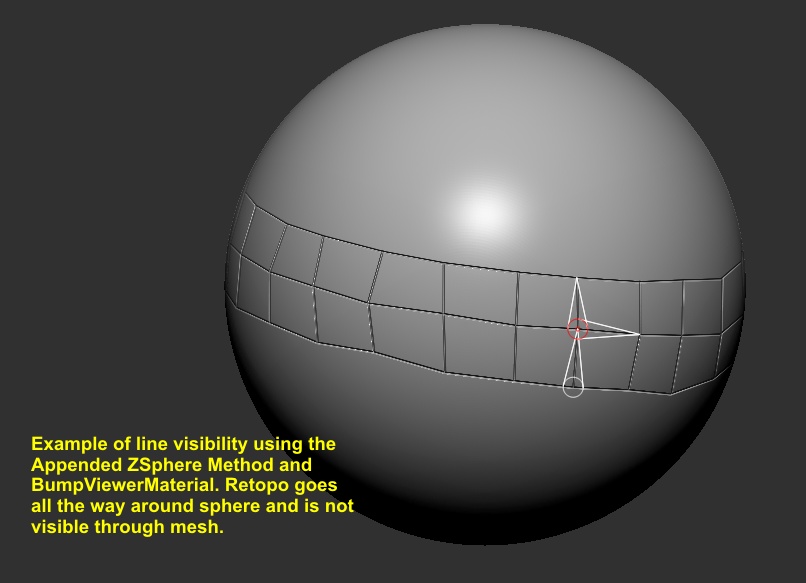

Make these changes in:
Preferences > Draw menu
Front Opacity 0.95
Back Opacity 0.01
For now, it’s better to use the Appended ZSphere Method for retopology.
