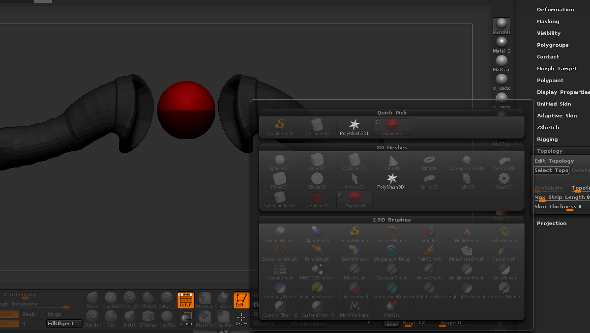

I think I’m missing something, I have zremeshed an arm and I have come this far. Now what am I supposed to select and edit?
I guess this is your problem:
Edit EXISTING topology with zsphere
· Go to a zsphere
· tool>Topology>select topo (the one we want to edit). It must be the active subtool of another tool. Otherwise you won’t be able to pick it.
· Now go to append in subtool menu and append the same subtool. This will create a reference under the editable topology of the original mesh.
· Now tool>topology>edit topology with zsphere active as subtool
· When finish make adaptive skin
But as I said there are multiple ways to do the same, this doesn’t make it less confusing
(deleted the second link of my old post a it was not relevant)
Ok it works but it’s very unintuitive that you must duplicate the entire tool just to be able to select the subtool that you want to edit, but thanks this will be useful. :smiley:
Zbrush is not a intuitive program. In any case you could have avoided the problem if you have not started appending the zsphere you want to use in the subtool you want to edit the existing topology. That is OK only if you want to create a new topology, but not if you want to edit the existing one. At the end anyway you will duplicate the geometry as you need to append it to the zsphere but not vice versa.
For any people who stumble upon this in the future, you don’t have to save the tool just click copy and a copy of it should pop up and then you can select that from the topology window.
Or append it to another tool or clone the tool. Save and load was never needed as all these operations will duplicate the subtool.
Yes my bad not copy, clone the tool.
