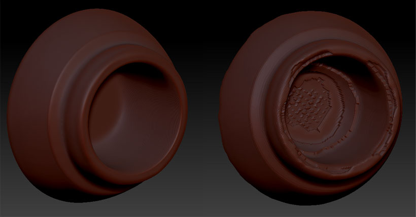

Hi everyone. I have started concepting and would like to make my final mesh before proceeding to detail it. I made a new mesh and had problems projecting it. So I then just went down a few sub D and did a Dynamesh. Then tried projecting all onto that. And these are the results i got.
Any help would be appreciated.

Use your “Dist” slider, and the other controls next to the Project All button, then try again.
The default value of the Dist slider is too low for most tasks in z4r2. Just increase it until you get satisfactory results.
Much appreciated. It worked like a charm.
