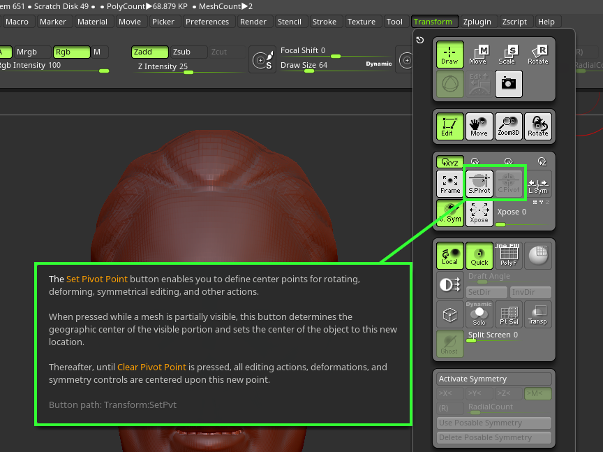

You can use S.Pivot and C.Pivot in the Transform palette.
2020-10-17 21_51_52-Zoner Photo Studio 17 PRO x64
Local Symmetry is also an option. Watch the video below to get a better understanding of S.Pivot and Local Symmetry.
