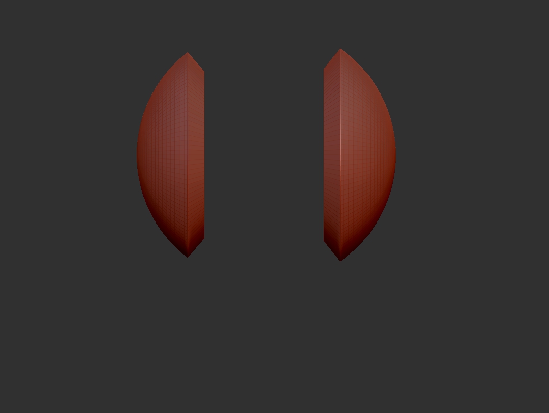

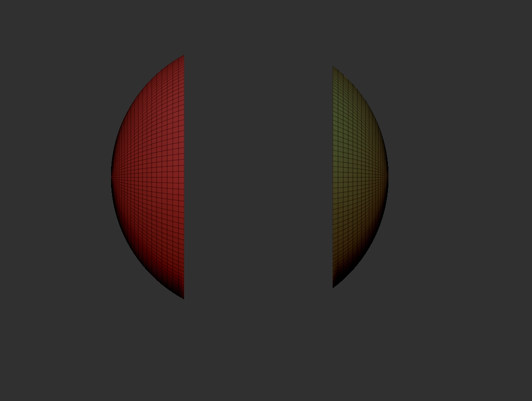

Make a polyshere, weld points as you suggest, Hide a centre section all way through sphere.
from here go to edge loops and select displace amount =1 and select edge loop to get this.
and in the same panel select remove loops with any angle and as I hit the button my program crashes. But I should get the other curved sides flattened according to the video tutorials.

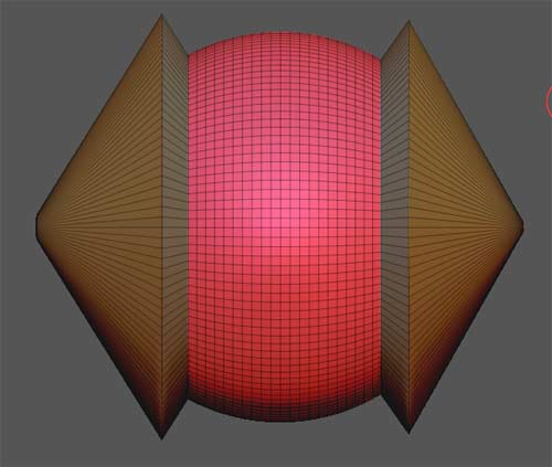

I can’t be certain I’m following the steps correctly, but when I follow along to the best of my understanding, I get this:
There are other ways to go about making this shape, but of course that doesn’t help you as you’re trying to follow a tutorial. Perhaps if I were to follow the tutorial in question directly.
In any event, I’m not disputing you may have an issue on your system configuration. If it would be helpful to you to try to recreate the crash on another system, I’d be happy to take a look at the file in question. If you are confident you have a bug, however, the Q&T boards are probably not the best place to report it. The file and report should probably go to Support along with system info.
The image you have ended up with is correct to the point of having a second tapered area moving towards the point.
