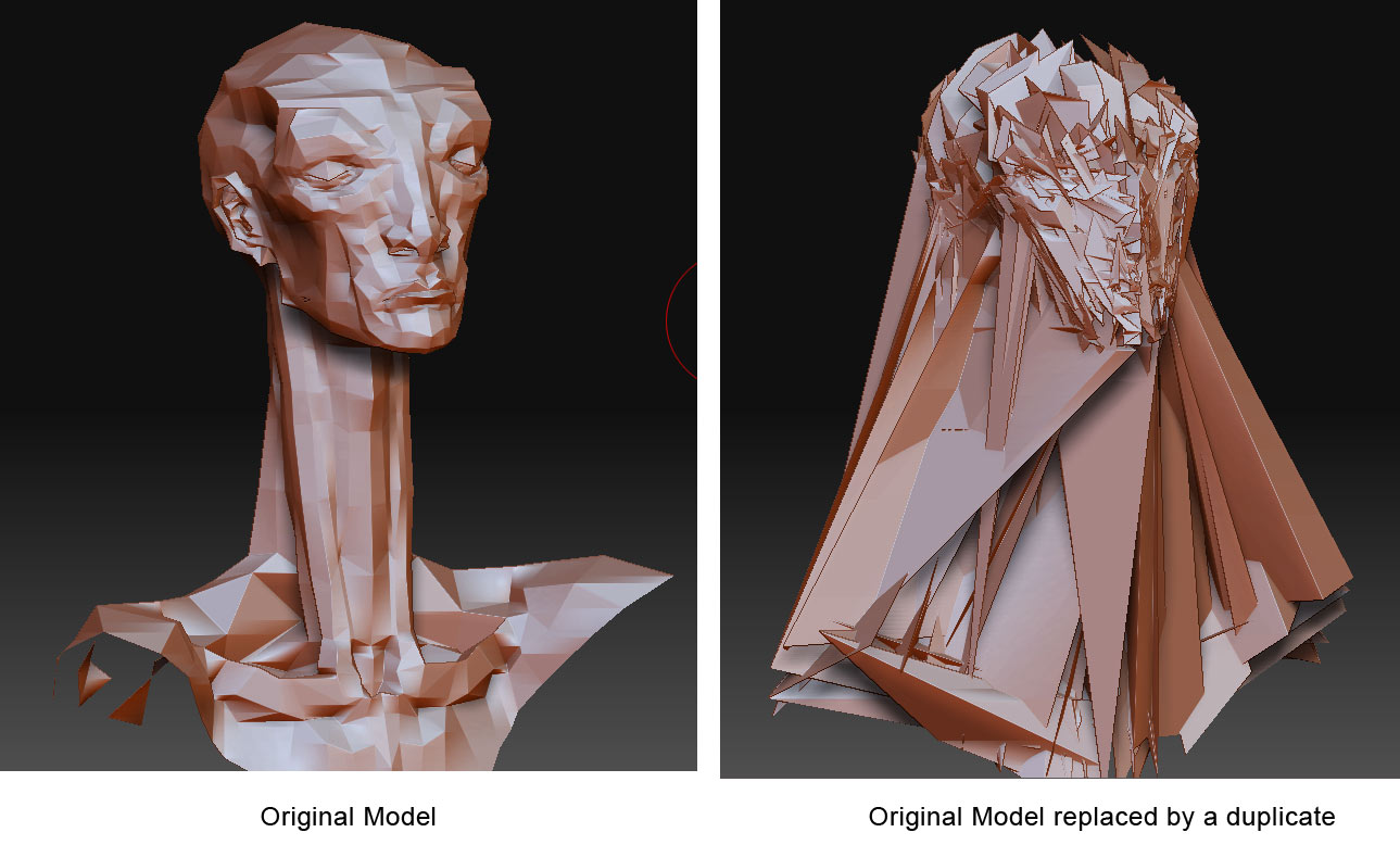

Ive included an image of what I mean. The image on the right shows what happens after reimporting a copy of the mesh and then switching to my morph target before I go back up the division levels from the base mesh.
This imported copy has been expoted by another app so although essentially the same I suspect its a point order thats causing the problem.
So my question is- is it possible in some way to effectively eliminate the existing morph, create a new one and then go back up the division levels and carry on sculpting?

you can export out the original again, and physically go in and change the vertex order of your new mesh so that it matches the old.
or you can just unwrap it again, or copy the UV’s from point A to B. But before you do that I would do some tests on a simple object to figure out where your point order is changing.
