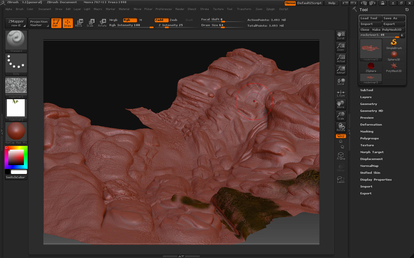

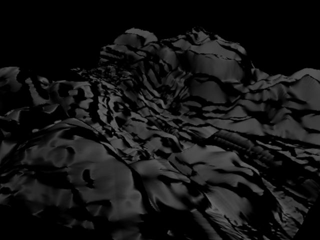

Im having some issues here. Last night I followed your guide to setting up the script and executed it. It seemed to work, (I was at school, so anything on the computer gets wiped everytime you log out). I logged off to take a break, came back tried everything again, every step, and it no longer works again. Even tried it several ways on my computer here at home. Ill post some pics.
The zbrush file is obviously what its suppose to look like, and the maya file is what im rendering out.
Any help would be great, thanks.
