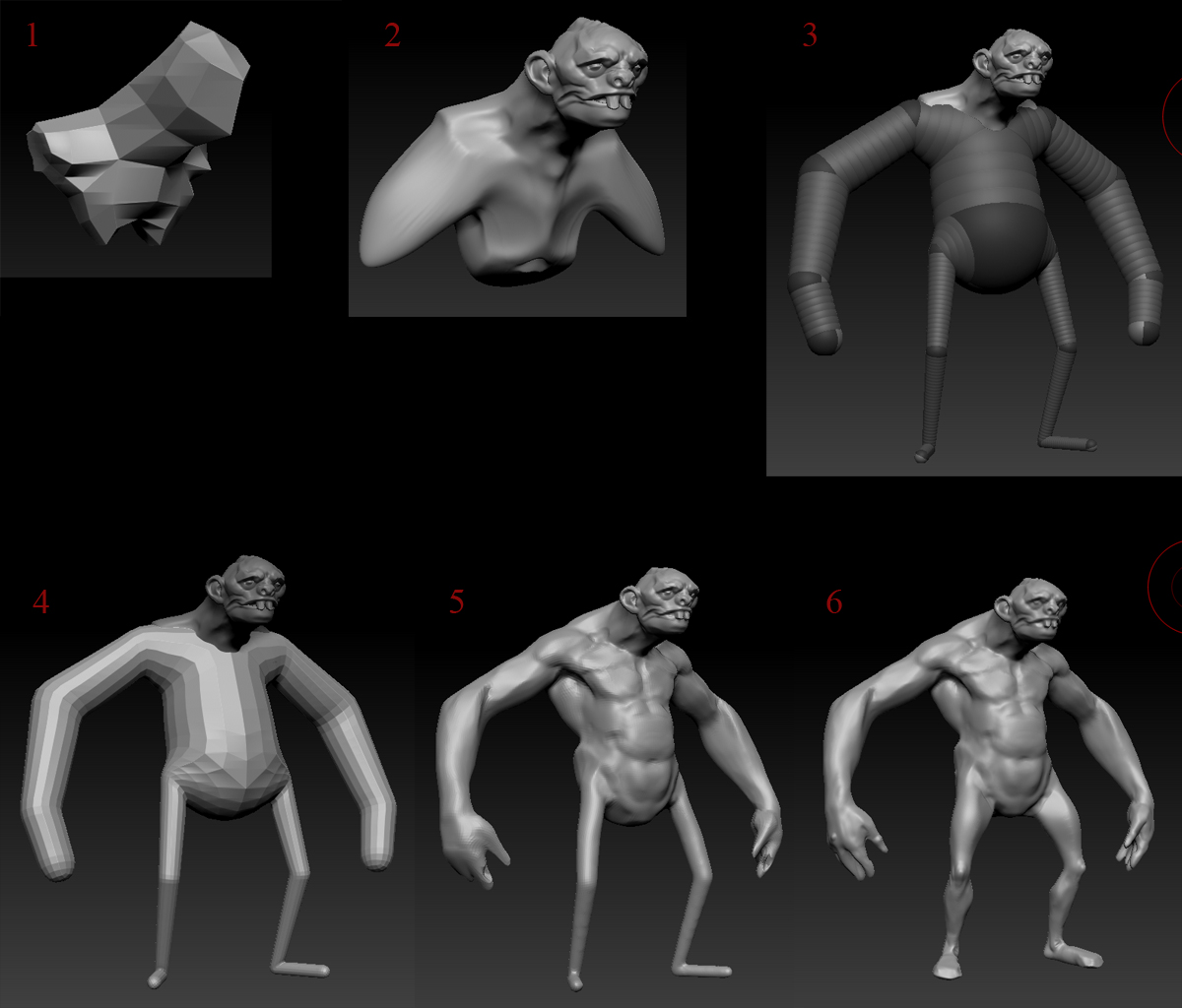

I just wanted to make a post that illustrates the limitations I’ve encountered with using the ‘remesh’ function in zbrush…I’ve actually found my way around the ‘project all’ problem I posted about earlier by simply turning off ‘maximum’ and PA Blur while smoothing and sculpting problematic areas out then in iterative steps reprojecting…

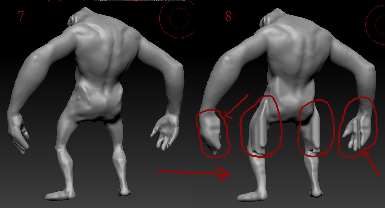

In the images below I place the steps to a workflow I would really love to use; by step 7 and 8, my fun is thwarted…the excess tumor like geometry becomes too burdensome to reproject and fit back to the original form, let alone sculpt on…If anyone knows how I could avoid this problem that would be great, because working like this is a lot of fun,…just sculpting without much of a plan,…stretching the mesh too far, then remeshing to take it further,…

huntek, what josh is pointing out is a bug in 3.5r3 with the unified skin routine(remesh) i’ve made a thread about this but got no official response, its too bad really cause i’ve yet to find a workaround besides taking it back to an older version of zb.
josh, for me project all is still buggy as well, even if i turn off those settings, and as i showed in that other thread it works fine in 3.1 without having to do smoothing and reshaping.
3.5r3 is buggered.
Thanks, spaceboy412.
hey josh. I really think it has something to do with the scale of the object. As a test Check your size of the body in the preview window within the tool pallet. THen hit unify on the sculpted body, then hit remesh.
I think the generated "remeshed" model will be more accurately calculated then. Altho it sucks the scale of that object is then changed. But for sculpting purposes its helped me a great deal. Solved my probs with remeshing.

thanks for the suggestion…u know this remeshing thing is kinda tricky…it does seem to alter the way the mesh is generated if I change the scaling…if I make the model smaller (it was not fitting in the preview window), it tends to lessen the severity of the distortions, but not completely…it seems also, that if I don’t want massive webbing and strange echo like artifacts, I must generate at a low res…this is fine for some topologies,…but when I have a character with fingers fore example it just can’t seperate them out…Do you know of something I could do further to refine my results (I hit unify to fit into window initially, then for a later test scaled down to a spec in the preview window, and still have artifacts…)
