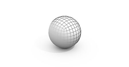

My guess is you’re using the 3d sphere instead of the polysphere.
Turn on your polyframe (wireframe) and check the flow of the lines.
Yours probably looks like this:
It should look like this:
Notice with the first one the lines all converge on the top and bottom. This is bad for sculpting in Zbrush and can cause pinching and smoothing issues. There’s nothing you can do if your lines (topology) flow in a different direction than what your detail and contour should be. You’ll need to use something like dynamesh and/or Zremesher to retopo. Or start over with the proper flow of the polysphere and then project the details over. When starting a new model the proper polysphere is easier to use.
