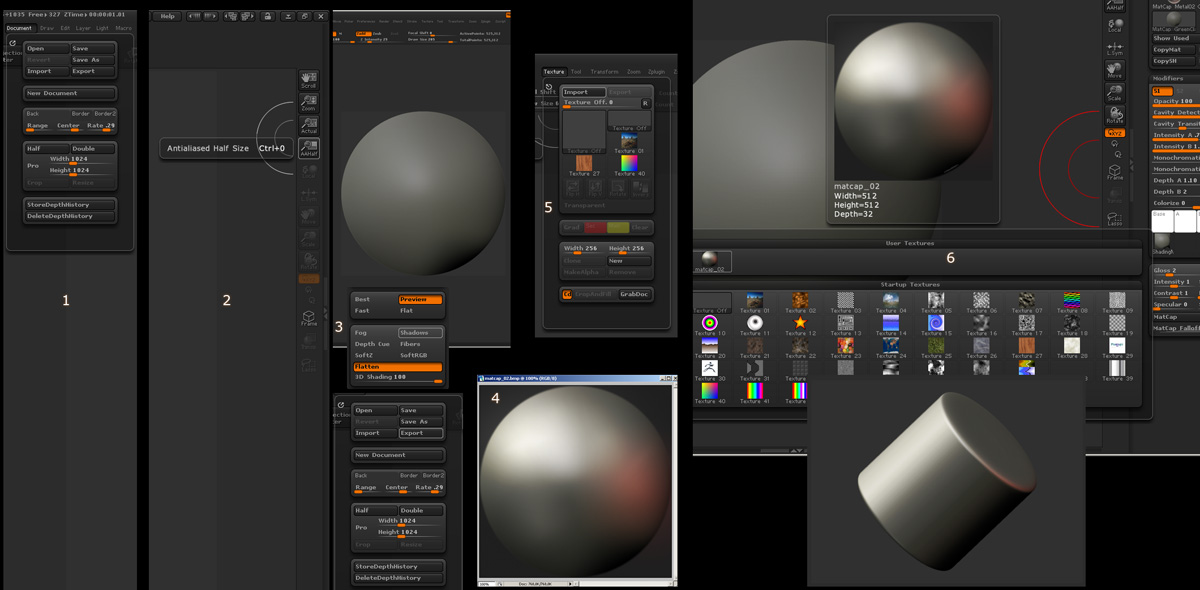

I’ve found at ZBC tons of super-cool materials and I take my opportunity here to thank those people who do such great stuff and share that to ZBC community. To render this image I apply many different materials to the model and then combined the renders in Photoshop using blending modes of layers. Cool thing about MatCap I’d like to mention is that it’s easy to refine it if you’re looking for something more specific.
Here is a trick:
1.Create a square size document, 1024x1024 is fine.
2.Press “AAHalf” button to get Antialiased half sized image.
3.Create a sphere, subdivide it a couple times until you get it smooth, apply a MatCap you want to refine and export image. Make sure your preview shadows are turned OFF in render menu.
4. Exported image you can edit in Photoshop and do whatever you want from changing color to adding more highlights. If you want to stay in ZBrush just convert sphere to pixols and use ZBrush 2D brushes. To do that just turn off Edit Objet mode (“T” hotkey) and pick a brush you need.
5. Import your edited image of rendered sphere back in ZBrush. I just added more highlights and edited color a bit.
6. Go to Materials/Modifiers/Material Texture and replace old sphere image with a new one.
You can go further. Combine this MatCap with ReflectedMap Material which is standard in ZBrush:
