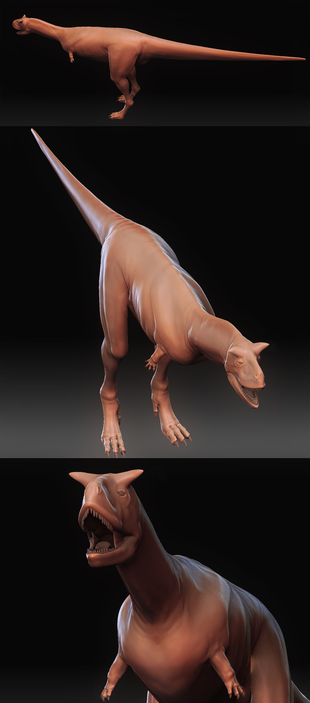

Howdy all, Zbrush newbie trying to start a “sketches” thread, today I come with a bad model and a question. My model is currently at 5 million polys but I find that’s not enough to sculpt more detail in certain areas like the eyes for example, now, I could divide it again but it would be 25 million but it’s so laggy it’s unsculptable so I’m asking you guys, is there a way to “instert” polys in some areas?
Thanks, and now a Carnotaurus WIP waiting for a fix to this solution:
