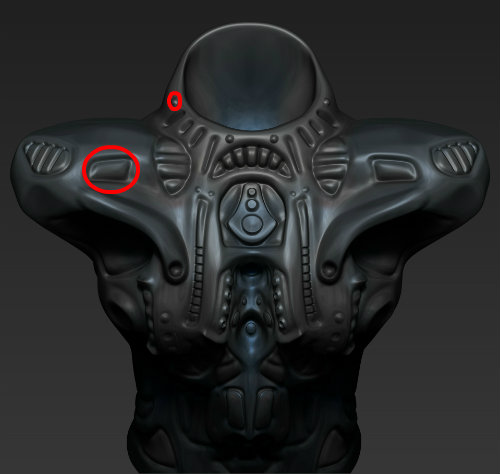

to parts of my mesh. For example i have this mesh:
and would like to apply some radial holes/cuts to certain areas of the armor.
My pivot point is off right now, because i moved the mesh in the process and
have a hard time defining a pivot point to an area, so that its not in a wrong angle
of the surface. Is this possible without splitting the mesh into subtools?

Hmm, let see. I want to use a radial symmetry on one of the elements, like marked here:
Because the whole mesh is one tool, without parts i thought if its possible to
align my pivot point directly in the center of the marked elements.
You can use Transform>Set Pivot (and clear Pivot) to set the pivot to the center of the visible mesh portion. However, symmetry will be limited to the selected axis so for radial symmetry to work well you may need to align the mesh on a particluar axis first.
