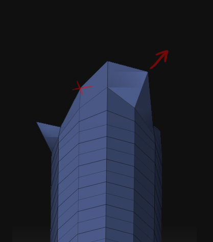

Hi, I’m modelling a cylindrical worm creature (the sandworms from Dune, if anyone’s interested), and its mouth is composed of three cone-like parts which can be closed to form a kind of tip on its cylinder body. If that wasn’t very confusing. In these two images you probably see what I mean.
Is this even possible to do?
you’re looking for a localized symmetry, which Zbrush can’t do. You can however detatch one of the mouth lips and center that piece. Then sculpt away on that piece using only X symmetry. Then place the object back into position as well as 2 more copies of the piece. You can then reproject the details back onto your original mesh.
So you can achieve the look you need, you just need a weird work flow to achieve it.
